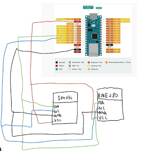

Combine Sen0321 and bme 280 but can't get the data
Can you guys help to check if the code is right?
and the picture is the layout for Arduino

Please post a schematic. Written descriptions are always more ambiguous than a drawing. Hand drawn, photographed and posted is fine. Include all pin names/numbers, components, their part numbers and/or values and power supplies.
Please read the forum guidelines to see how to properly post code and some information on making a good post.
Use the IDE autoformat tool (ctrl-t or Tools, Auto format) before posting code in a code block.
Please go back and fix your original post.
Thanks for your reply, I just updated my post.

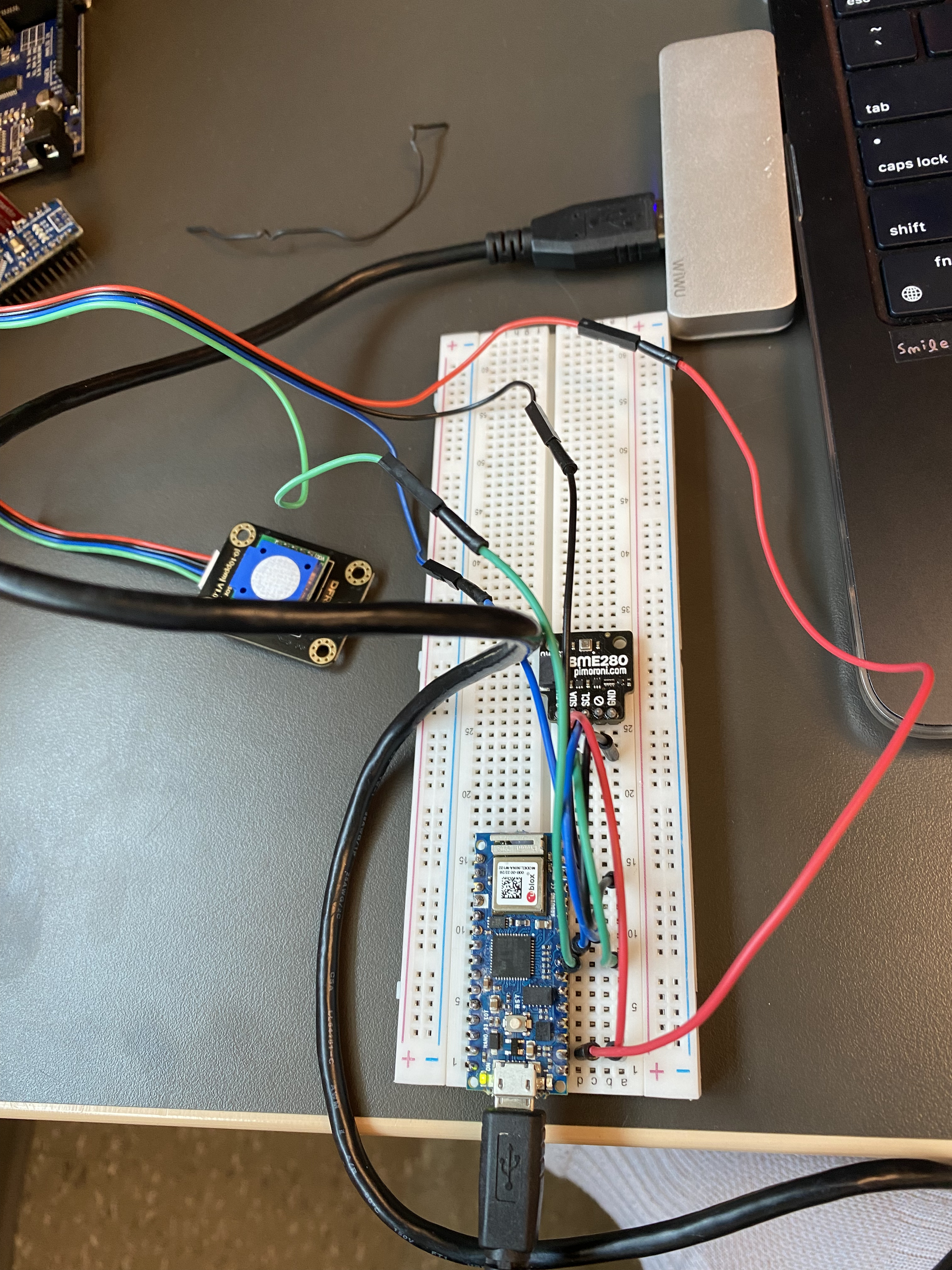

and I2C is:
I2C Scanner
Scanning...
I2C device found at address 0x60 !
I2C device found at address 0x6A !
I2C device found at address 0x73 !
I2C device found at address 0x7E !
done
Two sensors can run individuality with the code but when I combined together, no data is showing
The (improperly) posted code is incomplete will not compile. Please post a compete, minimal and verifiable code that demonstrates the issue.
