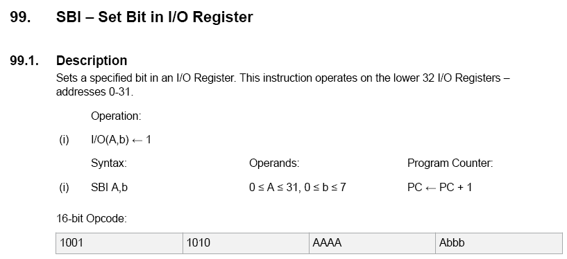

1. I am not absolutely sure; however, my opinion has been based on the following reasoning:
(a) Whatever might be the high level form of an instruction, it has to be active at the register level. Therefore, the MCU must execute the following sbi instruction for two times as the sbi instruction handles only 1-bit location of an IO Port and there are two bits to activate.
Figure-1: Template of sbi instruction
2. I have no tool to dump the assembly codes that might have been generated by the gcc of the IDE.

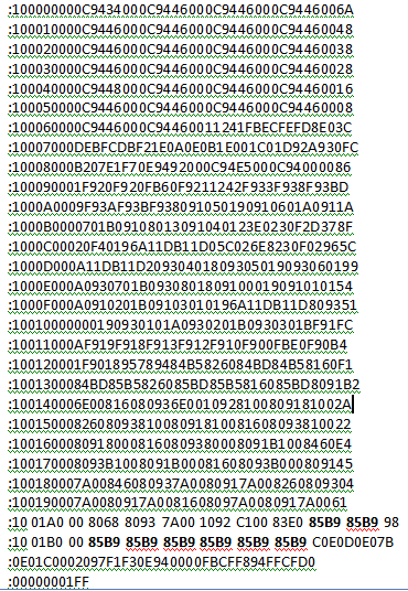

3. I have made a dump of the hex file of the following sketch containg PORTB = 0b000011; instructions. The machine codes (8 times done purposely so that I can spot them) are marked bold. The instruction (opcode+operand) is 85B9 -- a single 16-bit code that, most likely, has activated both PB0 and PB1 simultaneously; but, how? I have difficulties to derive this code following instruction of Fig-1.
  PORTB = 0b000011;
  PORTB = 0b000011;
  PORTB = 0b000011;
  PORTB = 0b000011;
  PORTB = 0b000011;
  PORTB = 0b000011;
  PORTB = 0b000011;
  PORTB = 0b000011;

3. bitwise OR is byte wide so it writes both bits at once. The asignments you have in this code aren't done with sbi. Even sbi has to read the register, or in the bit, and write the register. The RIGHT code here (#6) does the same thing but it sets both bits at once with a single bitwise OR.
When I assemble sbi PORTB, PB0 using Atmel Studio 7 for ATmega328P, I get this machine code: 9A28 (1001 1010 0010 1000 ---> 10011010 00101 000 = opcode + PORTB_address(0x05) + PBO_bit_address (0x00) which agrees with the following instruction template--
The machine code (85B9 = 1000 0101 1011 1001) generated by the gcc of IDE for the instruction PORTB = 0b000011; certainly activates both PB0 and PB1 in one clock cycle; it would be a great learning if someone can figure out the mechanism of how gcc has produced this machine code?
GolamMostafa:
I tried in response to your earlier post - and gave up. It is unbelievably obscure. The instruction appears to load register 0x1B from the Y register offset by nine.
The point is again though, that your instruction not only sets PB0 and PB1, but also clears PB2 to PB7.
