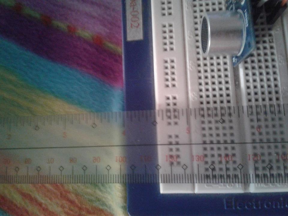

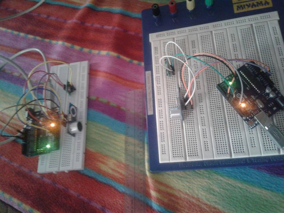

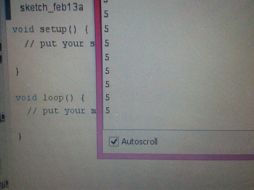

Logic analyzer waveforms showing sync, sync debug, and ultrasound trigger and echo. The offset between HC-SR04 trigger on the two nodes is about 55 microseconds which could be improved by removing the debug in RxRFSync() and/or calibrated out with delayMicroseconds:
Wow! Problem solved. The code actually works!!! Thank you so much! (see pics)

I'm glad it worked for you. It was a fun diversion, though it took longer than expected as it took a while to discover a non-functional HC-SR04 I'd pulled out of the parts bin.
Since I posted it occurred to me that the range for the receive node is one way time of flight vs round trip time in the code I used as a basis. Thus the range in cm should be duration/29.1 rather than duration/58.2. Also I thought adding a timeout to pulseIn() would make the system more robust to missed pings. I've updated the code above with these changes but haven't tried them out.
