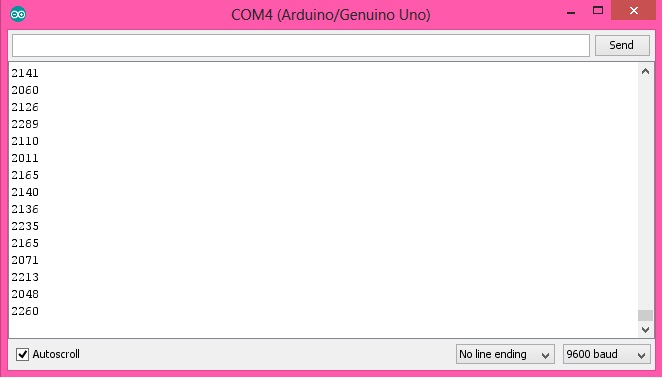

I did that too, I have the same setup as him however I get the pulseIn values such as these (see attached photo). He also claims that pulseIn means "how long the sound is heard for". I think its working and the two are actually communicating since when I unplug the tx side the values I get is zero. Is there any way I could convert that "time" to distance?
OPs pic..
But that is nothing like in the you-tube, the code is not even structured for the display layout shown in the you-tube.

Unless you have two signals being sent, one fast and the other the ultra sound you can't do it. You can not measure the distance from the signal amplitude or duration.
