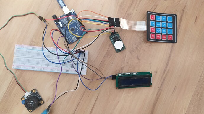

Compilation error: no matching function for call to 'LiquidCrystal_I2C::LiquidCrystal_I2C(int, int, int, int, int, int, int, int)'
What did I do wrong? Will you help?

Can you share a link to your display and a picture?

a picture of your set up I meant.
did you solder the I2C module to your LCD1602?
Yes, i solder it.
