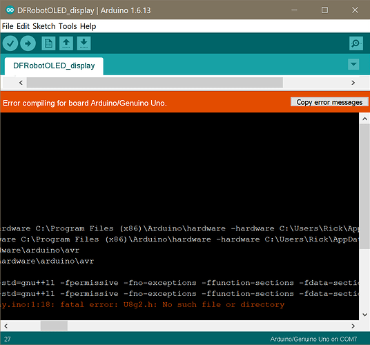

The Arduino IDE shows the U8g2 library present
but the compiler can't find it.
What have I got wrong?
Thanks
The header filename doesn't always match the library name. If you take a look at any of the example sketches under File > Examples > U8g2 you will see this:
#include <U8g2lib.h>
pert:
If you take a look at any of the example sketches under File > Examples > U8g2 ...
Now that is something I would never have looked for - the library comes in and brings examples with it. Pity it did not also bring an appropriate circuit diagram(I still haven't found one for this LCD PCB).
Back to the tutorial code, using #include <U8g2lib.h> got past the first hurdle but straight (Kerrashh!) into the second one

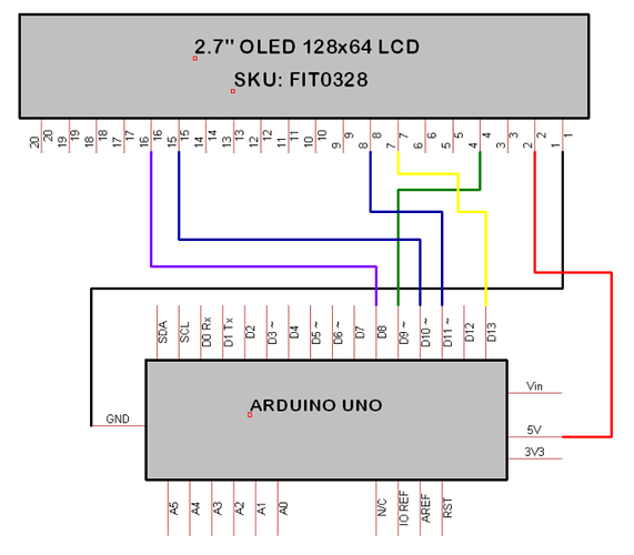

  1. remove the purple wire from "reset" and connect the purple line instead to pin 8
  2. Use U8G2_SSD1325_NHD_128X64_1_4W_SW_SPI u8g2(U8G2_R0, /* clock=/ 13, / data=/ 11, / cs=/ 10, / dc=/ 9, / reset=*/ 8 );

a) I have not checked your wiring. Your picture is not good enough for thus.
b) A breadboard like this may work or may not work. It is always a great source for connection errors
c) I can not image that this display works with 5V GPIO lines. I do not see any level shifters on the PCB. But ok, it says so on the product page...
Oliver
olikraus:
Herewith
well, then, does it work?
olikraus:
No.
That's why I am seeking help :confused:
We do not have a description of the pins of your display.
Here are some more thinks you should check:
  • Do the pins fit to your wiring
  • Is the an electrical connection between arduino and your glcd? As I said before, these breadboards are NOT reliable.
Oliver
