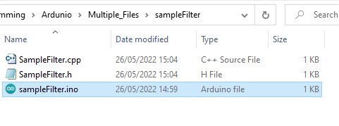

I have a directory with three files
SampleFilter2
IDE displays
.ino file
#include "SampleFilter.h"
  filter();
SampleFilter.cpp
void filter(void){
  Serial.println("in filter");
SampleFilter.h
#include <Arduino.h>
void filter(void);
when run the serial monitor displays
in filter
I created SampleFilter.h in H format but don't know how to create SampleFilter.cpp in C++ format
I just created the files using notepad and renamed them .h and .cpp
if you have a .c file rename to .cpp
I suspect this is Windows giving you trouble. I suspect your "SampleFilter.h" file is actually named "SampleFilter.h.ino". Can you turn on the "show file extensions" option? For some illogical reason, Microsoft still thinks it's a good idea to hide file extensions by default.
did not think of that! I tick 'View>File Name extensions' as soon as I get a new system
I did it, I changed this line
//#include <SampleFilter.h> = old
in cpp
Thanks, later I will work with setup and loop
