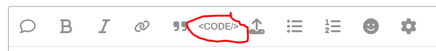

Please post your sketch in code tabs by using this button:

Please, correct Post #5.
