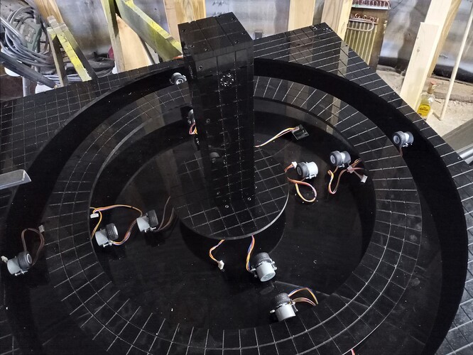

I've been running a D&D event called the Grindhouse Arena at gaming conventions for the past decade. This arena that I designed and built has eight players around the table all running gladiators in a trap-filled, spinning arena of glorious carnage and mayhem. The original was built from plywood and painted, and the moving rings of the board are moved manually each round of the game.
This has been a smash success, but I always knew I could do this better. I enlisted the help of an engineer, and the arena has been redesigned and rebuilt using laser-cut and etched black acrylic. The rings of the new arena will be driven using stepper motors and (hopefully) a push button.
What I have:
(16) 28BYJ-48 5V stepper motors mounted under the board, that will move the four rings of the arena (4 motors per ring) with rubber wheels to turn the rings Edited to add: each stepper motor also has a ULN2003 driver
(1) Arduino Starter Kit (with Arduino Uno) has been purchased and is on its way (but hasn't arrived yet)
(1) laser-cut and assembled arena, with stepper motors mounted and ready for wiring
(1) basic knowledge of electronic circuits and wiring that has been gathering dust on a shelf since I graduated college 20 years ago

New arena, work in progress shot:

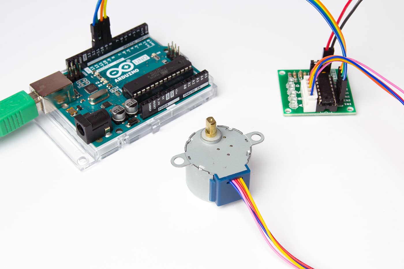

My 28BYJ-48 5V stepper motors came with ULN2003 drivers. Do I also need a motor shield?
If so, the description of this board says it can control 2 stepper motors. Do I need eight of these things??
Apologies for dumb questions, I'm reading up and trying to learn this as I go.
I wouldn't expect so. The ULN2003's weren't mentioned in the opening post so...
Are the drivers like these?:
Don't know. It's possible one channel could drive multiple motors simultaneously.
I was once told the only dumb question is the one you don't ask.
Pro-tip for lengthy links... delete everything from "/ref..." to the end. The meat of the above link:
Amazon.com: Adafruit Motor/Stepper/Servo Shield for Arduino v2.3 Kit : Electronics
Noted. Thanks!
Yeah, that's what I have. To be honest, when I first posted earlier today I didn't even know what ULN2003s are.

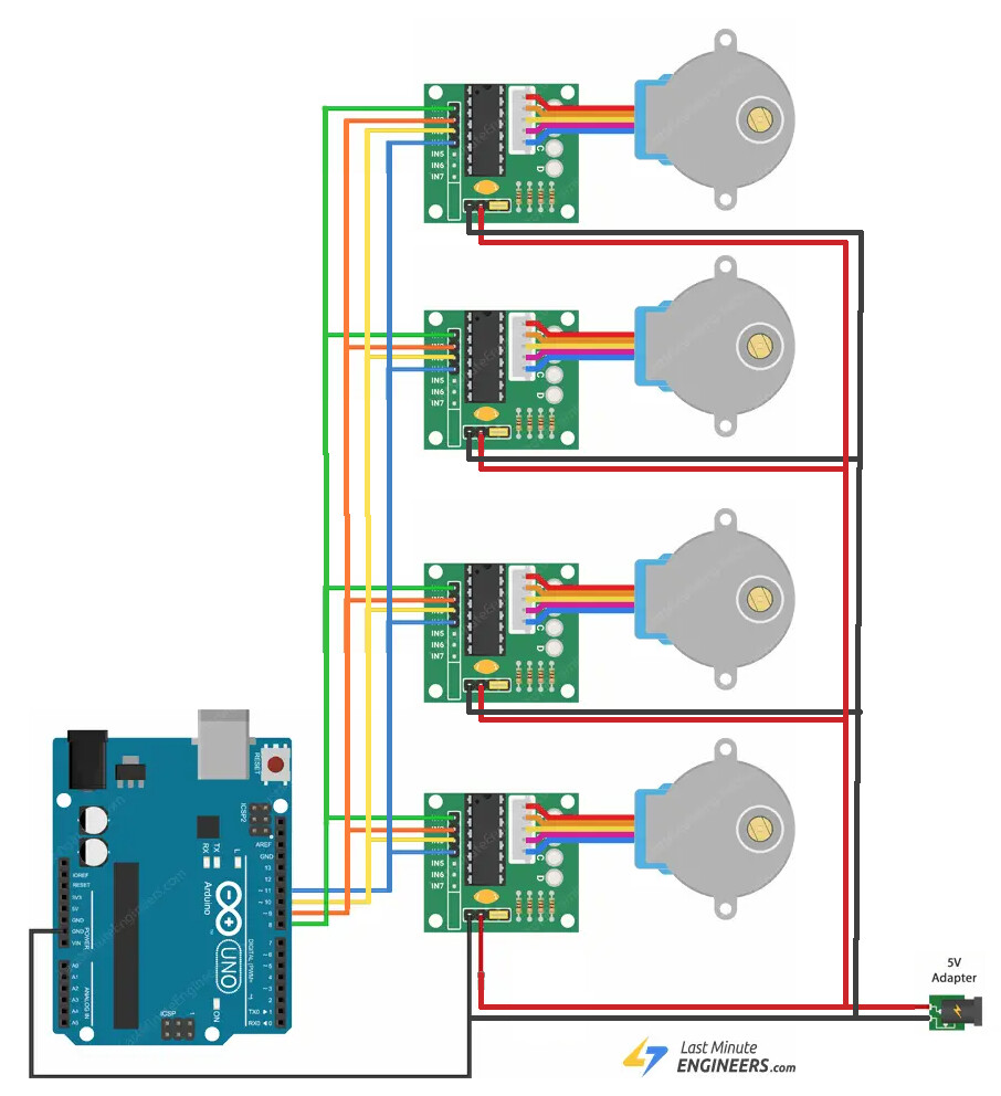

Okay, I'm getting ready to start wiring this thing up. Today's question:
Can anyone confirm whether I can drive multiple motors in parallel from the same four outputs, as sketched below?
I drew four motors, but actually I want to drive eight motors simultaneously.
I hope to drive eight motors from each set of outputs, for a total of sixteen motors, if the Arduino can handle it.
I reached out to Arduino tech support and learned that the above wiring diagram will NOT work. The Arduino cannot reliably control multiple stepper motors in parallel from a single set of outputs. So now I'm looking into just what I can do with shift registers.

Arduino tech support confirmed that I cannot run four stepper motors in parallel from the same set of four outputs, but they also confirmed that I definitely CAN run four sets of four motors from an Arduino with a shift register.

Did the Arduino guys say why you can't double up the stepper driver on one set of pins? I assume it would pull too much current. Shift registers would do it, but their strength is that the pins are individually addressable, so you can make each motor independent. Since you don't want that, they seem like overkill to me.
An IC that just switches some transistors and can handle more current seems better because then you wouldn't have to hack the stepper library to use the shift registers. I'm more of a software guy though, so I can't help you with the specifics.
Also, life would be easier it you had one stepper per ring. They would need to be stronger, pull more current and need a nicer driver I expect.
If you want to use the hardware you have and run a software solution, you will find it rather complex I suspect.
Yeah, tech support said it was going to be too much current draw on the individual output pins.
