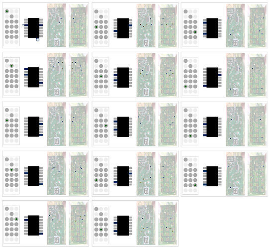

You need to decode the matrix to know how to proceed. I can't do that for you as it is too late at night and your first photo is useless. :roll_eyes:
You need to take photos in outside daylight (unless you have experience and a proper photo studio and equipment) but not direct sun.
Once you understand the matrix, you use one or more of the 74HC4066/ 74HC4051 devices to emulate necessary button presses. Note however that this switch IC (operating at 5 V) must always be powered whenever the remote is powered (which you can generally do from the 3.3 V output of an Arduino) and of course the negatives of the two devices are connected together.

Progress! Here's my attempt at decoding the remote. I don't understand The +/- flow of things yet, however it's good progress for discussion. The first button listed (power button) was convoluted as the circuit went under the chip. I can skip this one for now.

UPDATE: I realize that I should decode ALL buttons so that I can better figure out which connections are from power source. Sending an updated chart shortly...
Here's an updated chart with ALL buttons:

That leaves these remaining pins that go under the chip:
One is the mystery button pin, one is positive, one negative, one unused. I bet the one on the bottom right is the button pin, the one above that is positive, then negative on the top right. The one on the left seems unused?
