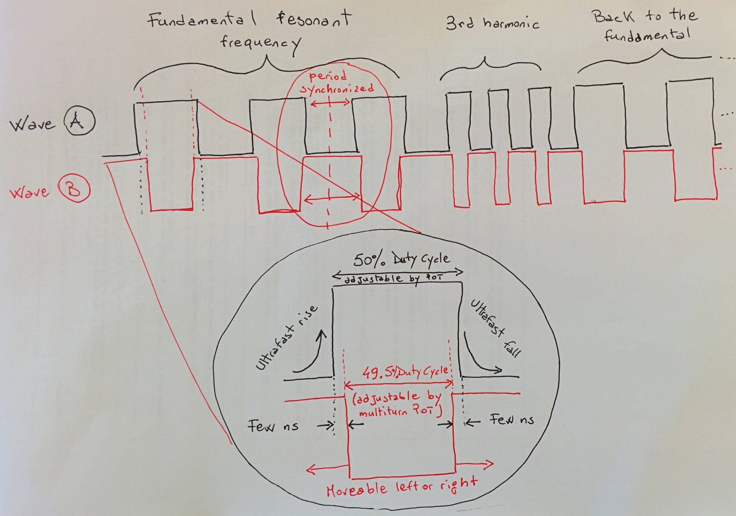

I'm currently in the research stage of a working principle which involves any RLC circuit, trying to harvest their back-emf spikes and store them for future use.
To accomplish that, I thought to an electronic DPDT (for the sake of simplicity an Half-Bridge) which needs an exact pulse sequence: in the attached images you can see the sequence I need to be generated by the Arduino's board (no matter of which board, Uno, Mega or Nano, just to make some tests, the final version - probably - will make use of a miniaturized tailor-made circuit).
I already developed, in the Arduino IDE, a small code to generate a very raw pulse, based on the idea I've drawn in the sketch, and it works beautifully...BUT! There are a couple of issues that I'm still unable to solve (to obtain an incredible gain, my final target):
  • first of all I'm unable to keep the inverted signal (the one in the sketch marked as "Wave B", the red one) narrower than the non-inverted one (Wave A) on-demand (through a multi-turn pot); I exactly know how to read a pot through an analog input, the problem is how to instruct the timers to interpret the read value and change accordingly;
  • the second issue is that, always speaking about the "Wave B", I'm unable to "move/shift" it, to the left or to the right, respect the "Wave A" (to make a delay or to anticipate the fall of the other waveform).
Every change I'll make to the duty cycle (or to the "Wave B"'s position, left/right shift) has to be kept in sync with the "Wave A" 's position & frequency - this is mandatory -.
The frequency of both waves A&B (always in sync) can then vary (with custom intervals, still to be investigated), changing from the fundamental resonant frequency (of the inductor under test) and its upper harmonics (mainly the 3rd but also the 9th).
Please pay attention that the above requirements are distinct:
  • the duty cycle of the "Wave B" (always narrower than the one of the "Wave A") and its relative position, serve exclusively in the setup phase - only once - to test the inductor's reaction to the pulse: the inductor is scoped during the fine tuning (via a multiturn POT) of the duty cycle and its position until the correct arrangement is found (then stored as a constant in the Arduino's code)
  • the varying frequency, from the fundamental resonant frequency and its harmonics, serve to detect the best sequence to be fed into the inductor (e.g.: 4 pulses @ fundamental freq, then 7 pulses @ 3d harmonic, then 3 pulses @ 9th harmonic, back to the fundamental... in a loop) and raise the voltage spikes even more.
That's it.
For me it's a big challenge but, probably, for you it could be a simple game.
Many thanks in advance for your suggestions/thoughts.

In your image, it mentions deadtime and being able to shift the waveform "few nanoseconds". The best timing resolution possible for this is 62.5ns with a 16MHz MCU.

because the "dead time" could be of some nanoseconds (the frequency could be in the order of some MHz: 2 or 3 at maximum).
You can't achieve this on a 16MHz processor.

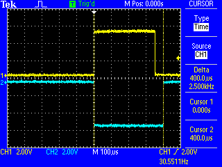

The rise time is not zero however, as you can see by zooming in. It's around 15 ns (some of that may be measurement error). I don't think you can get much better than that on this processor.

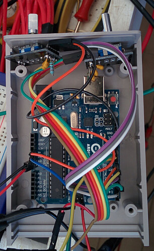

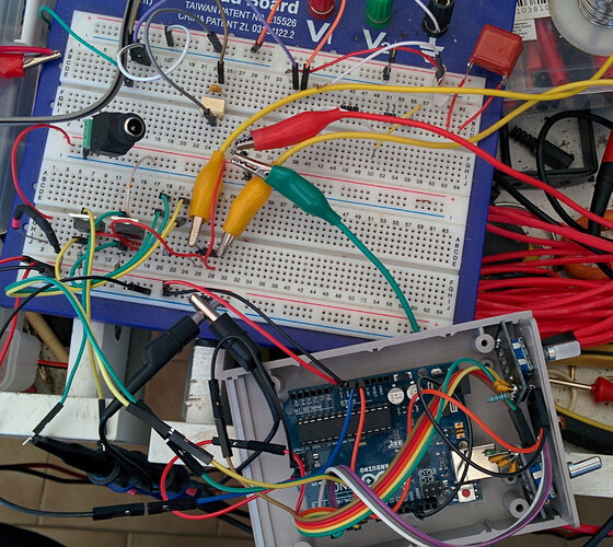

@Nick & cattledog: dear guys, thanks to your precious information I've reached my goal. Following, there is the code, comprehensive of the digital encoder's ( KY-040 Rotary Encoder Module) control, to manage the signals I was looking for.

The two digital encoders have been used here as digital potentiometers, allowing to change the frequency and the dead time (narrowing/expanding one of the two signals).
The numeric values coming from the two encoders are managed by two ISRs (Interrupt Services Routines, which seems to do not conflict with the timers used to generate the two PWMs) and there used to feed the main timers.
As you can see on the attached images, the whole circuit is a bit rude, but it works as planned.
The discrete component's part still requires some tuning and there is still the need to implement a decent MOSFET's driver but this is another story and it's out of the scope of this thread.
If you see something inadequate in what I've written inside the code or if you think that I could meet some unexpected behavior, feel free to note it to me.

Good work! Better not let that resistor on the encoder board hit the USB socket or sparks might fly!
Wow Nick, did you notice that very tiny particular?
Not only you've seen the proximity of the resistor to the USB's socket, but you've immediately understood that the resistor is on the 5V rail... impressive! (Did you, perhaps, read the wiring instruction inside the code? Tell me the truth... :wink: )
I would like to ensure that the whole circuit still need to be fixed on the plastic box and the two encoders have to be tighten with their proper bolts.
In any case, I don't think that the Arduino's board power can generate so many sparks... :grinning:
