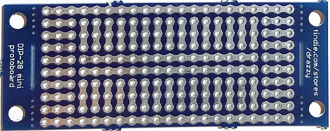

You also need a piece of circuit board material to build it on. I sell some lovely ones that are just the right size for a small atmega328p "perfboarduino" :wink: - my store has a bunch of other sizes and shapes of prototyping board, which is a lot less work than strip-board, and more convenient to work with because it's got copper on both sides, not just one like strip-board
