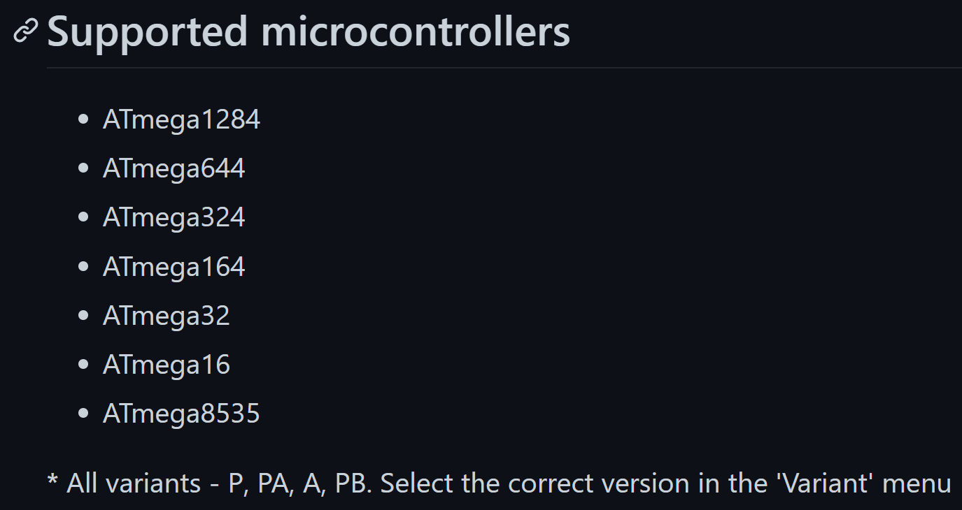

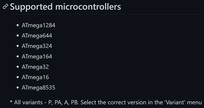

I use MightyCore when I am using an ATMega1284. I love the options of setting BOD, MHz, Bootloader, etc. I would love to use those options for the ATMEGA328 as well. And this is where I am confused. The github for MightyCore states in the readme a list of "Supported microcontrollers" which matches my board options when compiling. The 328 is NOT on that list! However, looking at the directory on my computer (...\MightyCore\hardware\avr\2.0.4\bootloaders\optiboot_flash\bootloaders)
I see a whole lot more CPUs listed than in the readme on github. I DO see the ATMEGA328!
So, I am confused as to why MightyCore includes the bootloaders for so many CPUs, but "doesn't support" them?

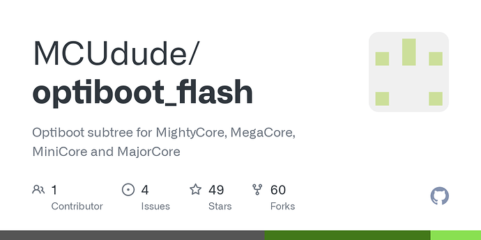

the bootloaders folder is linked to the optiboot_flash repository which is shared between MCUdude's cores.

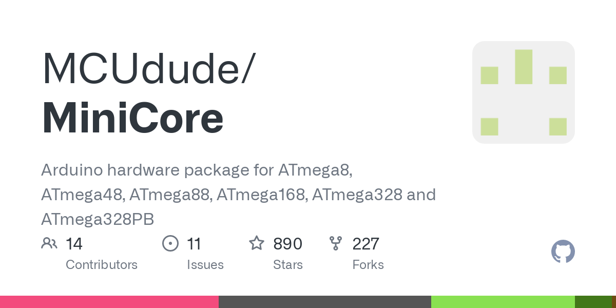

@mrburnette Atmega328p is in MiniCore and ATMega2560 in MegaCore
To supplement Juraj's answer, I'll share a link to the excellent MiniCore, which provides the equivalent configurability for the family of AVR chips including ATmega328:
As with MightyCore, MiniCore also uses the shared collection of Optiboot bootloader builds maintained in the MCUdude/optiboot_flash repository.
