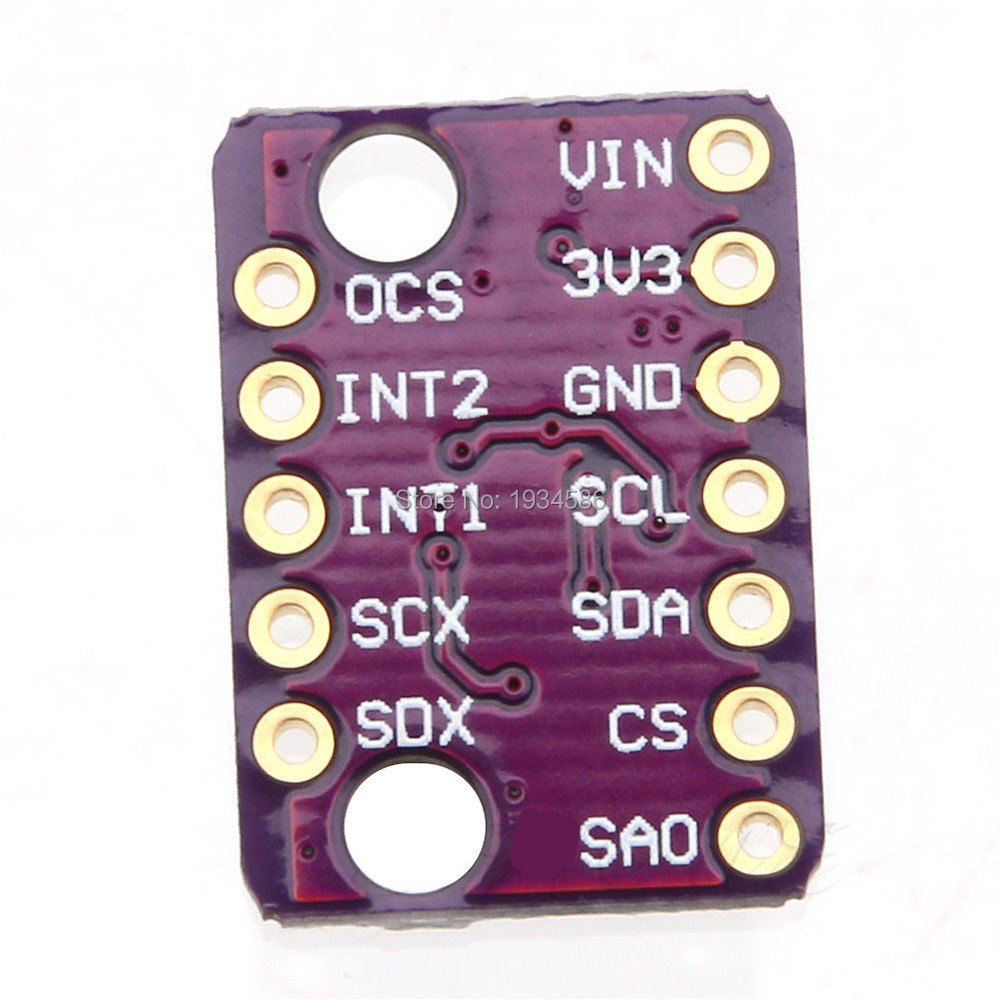

I searched and found some LSM6DS3 sensors for $ 3.52 each sensor.
It would be a total $91.52.
My doubt is, what would be the safest way? That would work of at least 30 readings per second?
SPI or I2C?
Sensor I'm looking at:
SPI is faster than i2c. If it is possible to get 30 readings from 26 sensors every second, then SPI can do it. But maybe i2c can also do it.
I suggest you should buy one sensor that can do both i2c and spi. Then you can perform some timing experiments to see how many readings per second you can achieve with i2c and how many you can achieve with spi.
