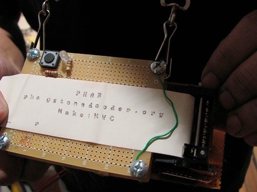

As for interfacing, someone has probably documented how the printer works. I found this (based on a BASIC stamp) pretty fast: http://www.instructables.com/id/MakeNYC-Badge-Contest-entry-from-an-old-GameBoy-p/

It should be noted that the MakeNYC project involves really bypassing a bunch of the parts of the printer, essentially using the hardware directly. It doesn't use the EXT cable link or anything.
