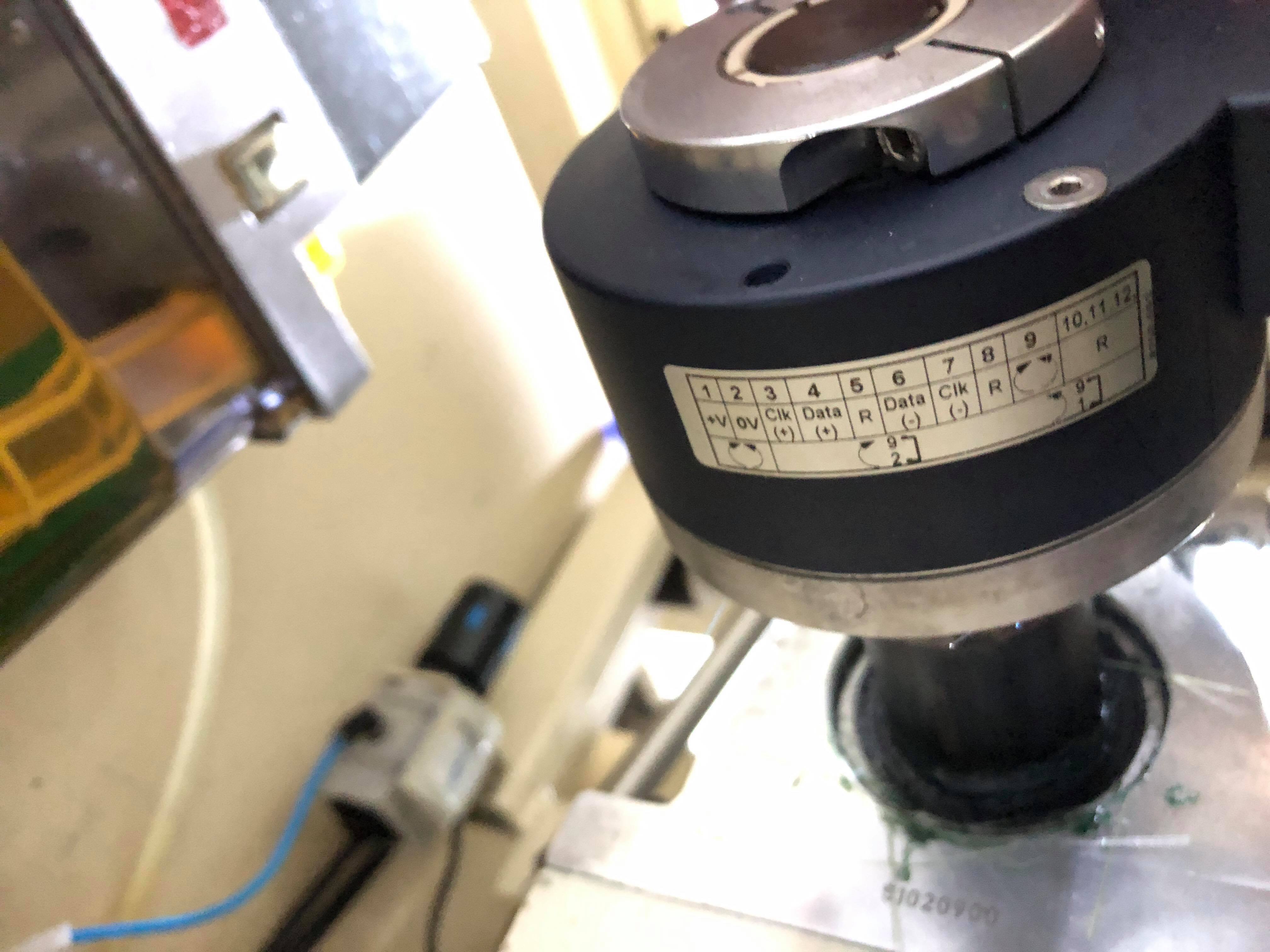

I have BEI encoder as the link below:

But I have a question: My encoder has VCC=24VDC. What SSI interface I need when I connect it with Arduino.

It appears that the encoder output is RS422, so you will need an RS422 or RS485 line driver as part of the interface.
The SSI clock input is supposed to be an optocoupler, so you may be able to connect that directly to an Arduino output (check whether a current limiting resistor is required, if so use 220 Ohms).

But how to connect this interface with Arduino, can you help me a schematic diagram? Pls, note my encoder use VCC 24VDC. It has signal pín: Data+, data-, Clk+, Clk-
Which line driver/receiver will you be using?
