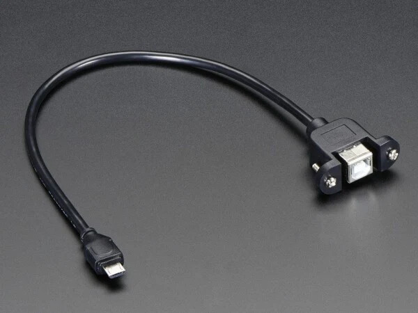

board cost 2-5$ and you makes yourself doubts about non existing problem that may be happen in far future?
if in your country arduino is expensive you may use such adapter placed in enclosure
зображення
or make one by self.
