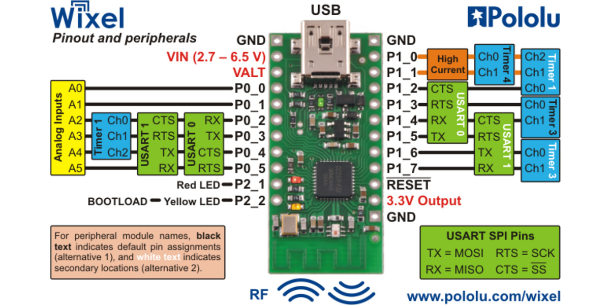

Here is the catch I want to connect the wixel to
the arduinos without the shield, mainly for
financial purposes, this is how I will connect it:
Wixel GND pin -----> Arduino GND pin
Wixel VIN pin -----> Arduino 5V pin
Wixel TX pin P1_6 -----> Arduino RX
Wixel RX pinP1_7 ------> Arduino TX

Here is the sparkfun link for it:
Here is a link for the pin layout:

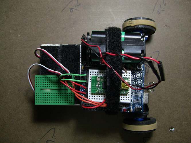

And here is a link for a project where a guy uses a similar layout but with an uno and computer:
I found a link for how to connect the wixel without the shield, if you need it here it is:
