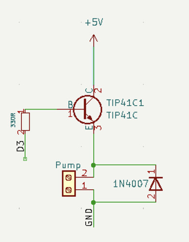

Hello all,
I have been encountering a problem with powering my environmental system prototype.
To give you an overview of my system, I am using an Arduino UNO, a DC Mini Submersible Water Pump (with a voltage range of 3V to 6V), a wifi esp8266 module (which requires 3.3V) and other air/water sensors.
w the external power supply is connected, the wifi module stops working, and I suspect this is due to voltage and current issues. Initially, the system worked smoothly, connecting to the wifi, operating the pump, taking readings from the air/water sensors, and sending them to the cloud before waiting for ten minutes and repeating the process. However, after the initial run, the wifi module refuses to connect.
It appears that combining these two components is causing a lot of issues. The system either works with the water pump only or the wifi module. I believe that there may be a problem with the voltage or current that is causing this issue.
I really appreciate any help, support and sight I have been struggling with this for weeks.
First of all your transistor circuit is inapplicable. Move the load and diode between + and collector. Even then the TIP transistors drop too much voltage, use a logic level MOSFET instead.
Thank Dr Diettrich,
Do you think the IRF520NPBF with 1N4007FFG will solve this issue?
Are there any other issues that you could identify in the schematic?

That's not a logic level MOSFET. Look or IRL...
The MOSFET and diode must support the voltage (5V) and current (how much?) of the load.

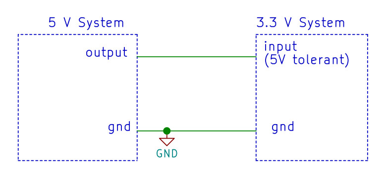

Well, there's no level conversion going on between the WiFi module and the Arduino, unless you're holding something back from us

No, I don't have any level of conversion, is it impossible to run the project without it?
This is a full circuit of my project apart from the water PH sensor communicated through I2C.
Any suggestions for the best level of conversion component and correct wiring?if possible

You do absolutely need level conversion. If you don't use it you could end up destroying your ESP01. In response to your question, read these two links which I got from @alto777:
To quote @alto777:
Take your pick. I like using a voltage dividers and relying on the logic level thresholds.
Just don't put 5 volts out to an input on the 3.3 volt parts.

Thanks to everyone who helped me in understanding the concept of logic level MOSFET. I spent an entire day studying various tutorials to grasp the main concept, but I am still a bit confused about which diode would be suitable for my system and the correct wiring.
I have summarized the specifications of the component and created an initial schematic, but it may not be entirely correct.
I would be grateful if any of you guys could provide me with advice.

No !
:scream:
The 5v will short to GND when the MOSFET turns on !
You need to do it like this:

A 1N400X (ex. 1N4007) is good for a load that is less than 1 amp
Where usually the 1N4001 (35V) is sufficient.
Schottky is not normally required, it will slow down the turn off.
As mentioned, any 1N400X diode could be used.
