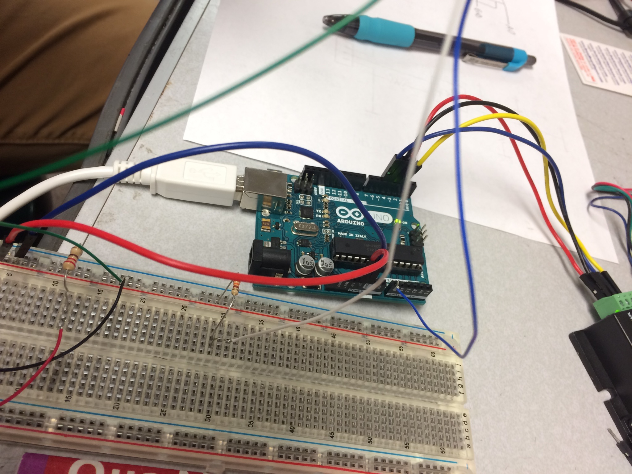

I am unsure how to draw the schematic correctly if my previous one was incorrect. I will send you a picture. The thin blue wire is the output which is connected to A0, it runs directly from the photomicrosensor. The 5v pin on the arduino travels to the breadboard.The white wire is the Vcc which has a 330 ohm resister preceding it and is connected to the portion of the breadboard with the 5V pin. The thin red lead is the anode and has a 220 ohm resister preceding it, also connected to the 5v pin. The green wire is ground which is connected to the GRND pin of the arduino. The black wire is the cathode which is also connected to the GRND pin.
I will attach the picture. I really appreciate all the help. I know I am probably not explaining it the best way but i am inexperienced and dont know how to draw a "correct" schematic. Maybe you could help me wiht this.
The photo is useless, because it does not show the sensor.
