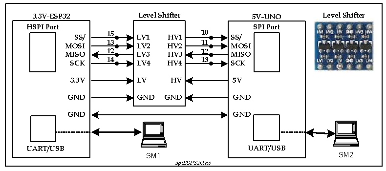

Check if the following connection diagram (Fig-1) does some help!
Figure-1:

===> Si4432 radio = new Module(15, 16, 17);
The ESP32 Dev Module has two SPI Ports -- VSPI and HSPI. Which SPI Port is being used by the Library? I have made a connection using HSPI Port.

So are you saying that if I follow that wiring diagram, and run the code with pins 15 16 and 17 it should connect?
I don't own that Module; so, be sure on the validity of that wiring having consultation with prduct specifications. Anyway, there is not much for anything to get fried; because, both radio and ESP32 are on 3.3V logic.

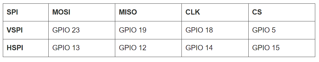

If anyone else has this module and needs help it worked connection using the VSPI pin equivalent from @GolamMostafa's diagram on the esp32. There were a total of 8 required pins, 1 3.3v and 1 GND, and then the entire top row (6 pins) from SDN and SDO. SDN and nIRQ are still connected to 17 and 16 respectively, and the others use the corresponding VSPI pins from the HSPI in the diagram (in @GolamMostafa's diagram pins 14 12 13, and 15 converted to their VSPI counterparts from the table below)
Using the example code and setting it to use pins 5, 16, and 17 I was able to get a connection and send data.

1. The execution of the following codes tells that the default SPI Port of ESP32 is the VSPI Port. Son when ans SPI.transfer() code is executed, it is directed to VSPI Port.
  Serial.print("MOSI: ");
  Serial.println(MOSI);
  Serial.print("MISO: ");
  Serial.println(MISO);
  Serial.print("SCK: ");
  Serial.println(SCK);
  Serial.print("SS: ");
  Serial.println(SS);
void loop(){}
Output:
MOSI: 23
MISO: 19
SCK: 18
SS: 5
2. I have the paln to test the functionality of HSPI Port using the setup of Fig-1:
Figure-1:
...pending
