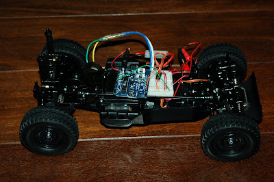

I was wondering how to connect this ESC to my Arduino board. If I connect my 7.2V battery pack to the ESC, the
servo-like connector of the ESC will deliver 5V which could power the Arduino.
The question is how to connect the control pin (orange wire of the servo-like connector).
Should I control this ESC like a servo, so firing pulses at 50 Hz and modifying the width of the pulses to control the voltage that goes
to the motors, or should I use one of the Arduino PWM pins in high frequency to control the ESC.

Yes, you control this sort of speed controller like you would a servo, with a 1-2ms pulse 50 times a second or so. You can probably use one of the existing 'servo' libraries, even...

Thanks. That makes sense. I tried this, but it does not seem to work yet.
I sent the same signals as I would sent to a servo via the signal wire. I sent pulses each 20ms.
I would expect that by sending pulses with a width of 500ms I would get maximum revert and by sending pulses with a width of 2000ms I would get maximum forward. Similar to the -90 and +90 degrees of a servo...
Did you mean 500/2000 micro-seconds? Or did you do 500/2000 milliseconds?! You want the former; every 20 millisecond you send a pulse, the pulse would usually be between 1 millisecond and 2 milliseconds long (1000 and 2000 microseconds.) 1.5 milliseconds is usually "center", and there's some variation about how far from center the limits are.
I found This manual that seems to indicate that you might need a special startup procedure to "program" the speed controller. Do you have a regular remote control setup (transmitter/receiver in addition to the ESC) that you can test the setup without any arduino being involved?
Sorry, I meant micro-seconds.
Thanks for the startup sequence tip! This makes a big difference.
1500 us pulses now result in 0V output to the motor, 2000 us results in +7.5V and 1000 us pulses in -7.5V.

Great! I was reading about the startup sequence, thinking "that makes sense from a radio-control point of view, safety-wise. You don't connect your motor and have it start running without some explicit interaction with the user. But it's likely to be a real pain to automate!" (I guess not too bad, since you have it working already!)
Having a working ESC, I connected the components together and I now have a first driving HummBot!
Have a look at: MegaBot Blog: HummBot drives!
