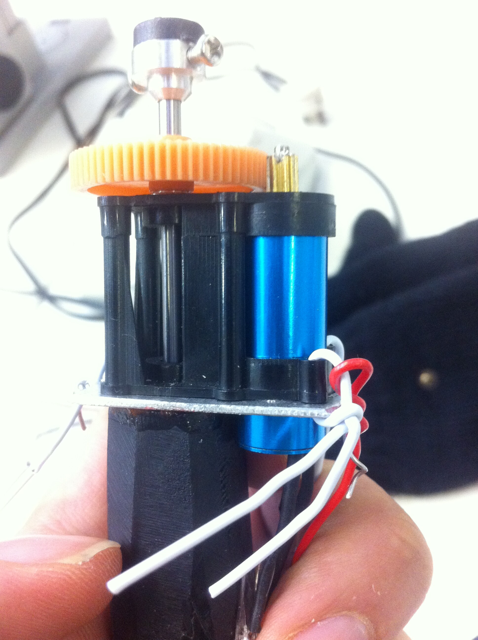

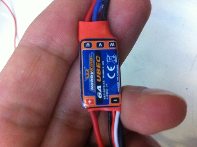

What I am trying to do is to control the motor speed using a potentiometer. Ive connected a motor (MEDUSA 4300kv) to an ESC (picture attached) the ESC is connected to a regular 9V battery for power supply, the other end is connected to the Arduino ground (black wire from ESC) and a PWM pin for signal output (white wire from the ESC). NOTE I didnt know what to do with the red wire and from my understanding I didnt really need to connect it to the board. I used the following code which I got from the Arduino.cc example pages (the potentiometer is connected to A0 port, Ground, Arduino 5V pin):

The problem is that the motor doesn’t go at full capacity or even close, I know this because it (motor and ESC) has been tested using a different control board that was controlled using a R/C transmitter-receiver set up with a variable power supply as source.

You are going to have to look up some data on the speed control. Most will list some sequence for ARMING the speed control like they must be set to low throttle for a short period of time and then advanced to half throttle and then back to low throttle. They will beep several times indicating that power has been applied and to signal that they are ARMED. If you don't go through the arming sequence they won't run the motor. Its for safety - Imagine attach the battery and your radio is at full throttle and you would have a real handfull...
It looks to me that what you have got is a UBEC and not an ESC.
Anyway check your battery when it is under load to see if you have the voltage you are expecting.
NOTE I didnt know what to do with the red wire[/quote]
You are right, don't use the read wire, on an ESC that is the positiv wire that deliver power to the receiver and servo's
Ah, you don't mean the little rectangular 9V "transistor" battery, do you?
There's not nearly enough current capacity there to run a motor as large as that one looks.
-j
ESC even for a small motor like that will probably take 2 to 5A peak to spin-up - a small battery is hopeless for RC brushless motors - they are designed for extreme power density. NiMH or lithium power pack as recommended by ESC manufacturer is needed.

Yes it is. The ESC used to control and power a brushless motor expects a servo signal (a pulse between 1000 and 2000 microseconds every 20 mS).

This is exactly what the servo library do, no need to invent your own.
what do you mean current capacity?
Voltage is only one component of the electrical power provided by a battery. The other is current.
how do i know what a batteries current capacity is?
The only sure way is to read the datasheet.
Some chemistries provide more current than others. In general, larger batteries of the same chemistry provide more power than smaller batteries.
If your 9V battery is like this, it's a very small size of a lower powered chemistry, so you're only going to get a few tens of milliamps of current.
