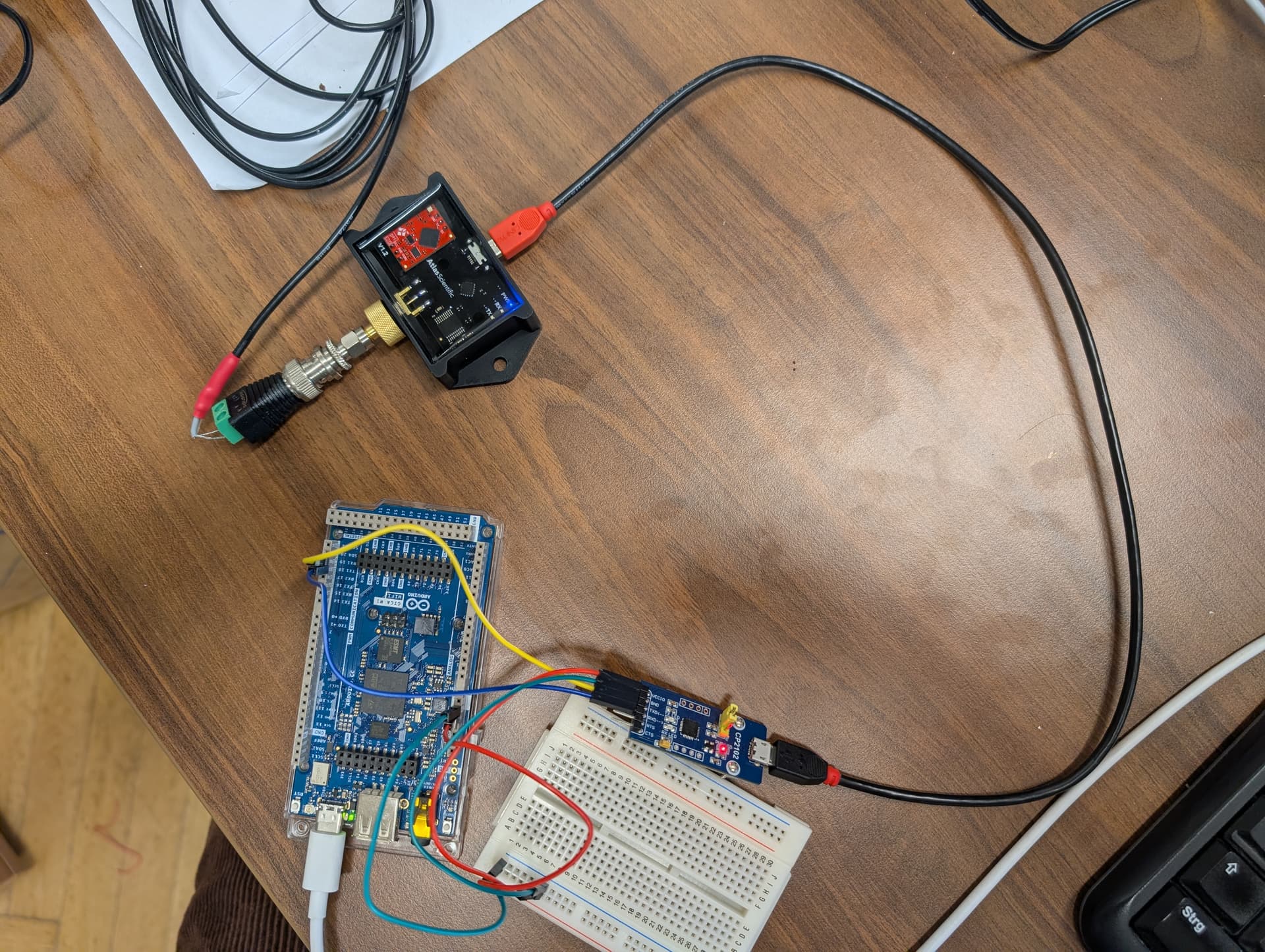

I'm a complete beginner working on my first Arduino project and need some help troubleshooting. My goal is to build a pH controller for leaching experiments. Here's the hardware I'm using:
The Issue:
When I connect everything as shown in the attached pictures, I cannot receive data from the pH Meter on my Arduino GIGA R1. Nore can I send commands from the Arduino to the pH Meter.
Here's what works so far:
  • Connecting the pH Meter directly to my PC via a micro-USB to USB-A cable allows me to observe and control it using Termite (e.g., sending commands like "R" or "C,1").
  • The data output is visible, and the meter responds to commands correctly in this setup.
However, when I try to interface the pH Meter (via the EZO Complete pH Circuit's micro-USB) with my Arduino using a Waveshare CP2102 USB-to-UART module, I don't receive any data on the Arduino.

Show us the sketch in code tags you are using to 'talk' to the device.
I don´t really know how to provide tags of code, but here is the whole code. For testing reason, it is very basic and I just wanted to check if I can get a response of the ph Meter to the Arduino.
  Serial2.begin(9600, SERIAL_8N1);
  Serial.println("Arduino is ready to communicate with EZO pH meter.");
  Serial2.println("R"); // "R" is the command for a single pH reading
  Serial.println("Sent command: R");
  // Wait for a response
  delay(2000);
  // Check if any data is available from the EZO
  if (Serial2.available() > 0) {
    String response = Serial2.readString(); // Read the response
    Serial.println("Received response: " + response);
  delay(2000); // Wait before sending the next command
