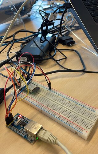

I'm new to working with ESP32 and Arduino, currently interning at a company where I'm tasked with developing an IoT project involving the ESP32S3 Walter (Walter). The project involves connecting to a PLC over Modbus TCP Ethernet to retrieve sensor data and then uploading this data to the cloud.
I've purchased an Ethernet Shield (W5500 Ethernet Module) (https://www.tinytronics.nl/en/communication-and-signals/ethernet/modules/w5500-ethernet-module) to facilitate the connection between the ESP32 and the PLC. Initially, I'm trying to test the Ethernet shield by connecting the ESP32 to my laptop using an Ethernet cable (as shown in the picture attached).
However, I'm struggling to find examples or documentation on how to set this up. Can someone please provide guidance or point me in the direction of resources that can help with this? Additionally, if anyone has experience with similar setups, I'd greatly appreciate any tips or insights you can offer.

I just saw this topic. I'm the creator of Walter (Walter) and I'm more than happy to help. I think a good starting point would be to use this sketch: GitHub - kethort/io-over-tcp-modbus-arduino-mach4: Provides extra inputs and outputs via Modbus over TCP using an Arduino Mega and W5100 or W5500 Ethernet Shield and communicating to Mach4 CNC software.
