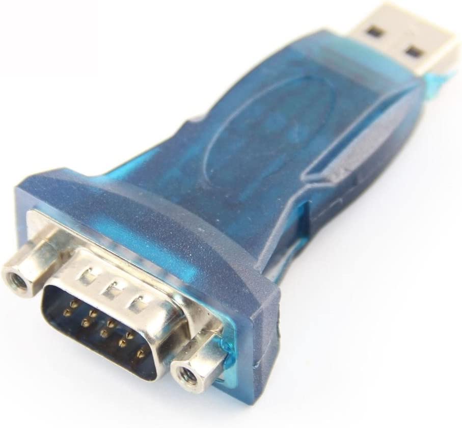

Is it possible to connect a D-type to the USB Com port? If yes, what do I need to buy?
How about this?
Not directly. However you can get a USB to RS232 converter built into a cable.
There are lots, here is one:-
http://www.amazon.co.uk/USB-RS232-Converter-Cable/dp/B00077DJIQ
Just ordered one of these.
