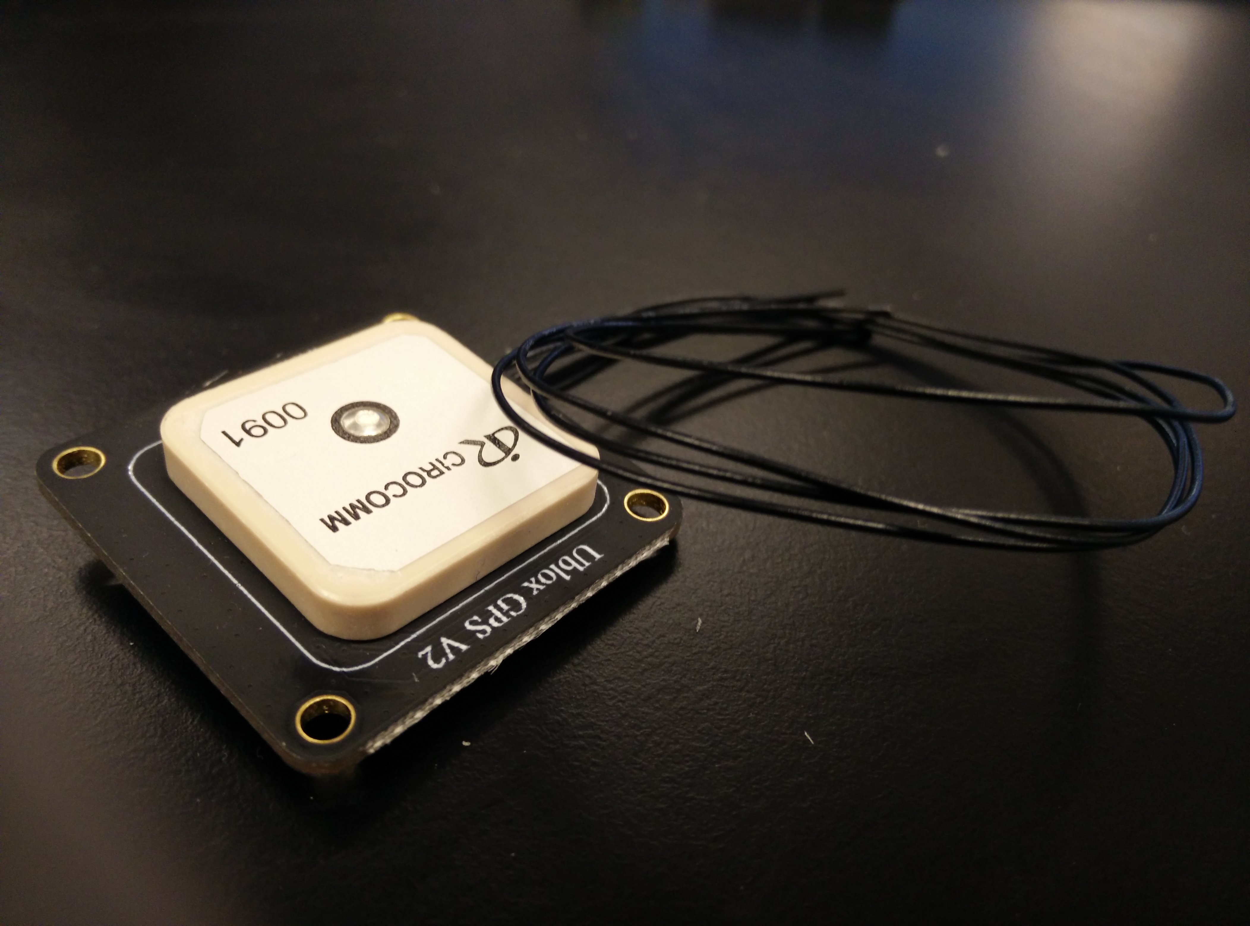

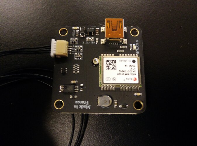

We've just started working with the Arduino, and made it ourselves difficult. We are making an Pet track collor. I'm now busy with connecting a GPS module to the Arduino, but I'm already stuck.
Some photos:
See attached files
Link to the module:
Can someone give me instruction how to connect this thing? Thank you so much!

There are 4 wires coming off of the GPS board - RX, TX, ground, and power. It isn't that difficult to figure out which one goes where on the Arduino, is it?
RX to TX
TX to RX
(Makes no difference , just this one to the other)
VCC/power to +
GND/ground to -
Thats not too hard indeed, but how can I connect them, I cant simply plug them in right?
What makes you think that you can't? Not that I'm saying you should?
Are you talking software? Look into tinygps.
I think that is not your best choice of GPS module. I had a quick look at the user guide, and it is designed with USB as the interface, the majority of GPS modules used with Arduino are serial or TTL output. I think you are introducing unnecessary difficulties if you are relatively new to Arduino.
Sorry it is not the reply you may have been hoping for! :slightly_frowning_face:
