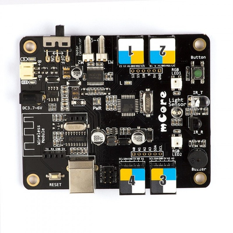

I have a personal project with an Arduino Uno from a Makeblock kit that uses an MPU6500 accelerometer.
I’ve previously used an MMA8452Q accelerometer, so I tried connecting the MPU6500 the same way as the MMA8452Q, but it didn’t work.
Here are all the components I have:

Well the pinouts are different so how could you possibly connect them the same way?
Sorry "in the same way" is a bad translation from my native language (french)
So here is what I have done :
mCORE MPU6500
VCC VCC
GND GND
SCL SCL
SDA SDA
And the I2C scanner from arduino framework doesn't found the sensor.
But the MPU6500 has 10 pins : VCC, GND, SDA, SCL, EDA, ECL, AD0, INT, NCS, FSYNC.
A logic level shifter is required for all I/O connections when using 3.3V sensors with 5V Arduinos.
