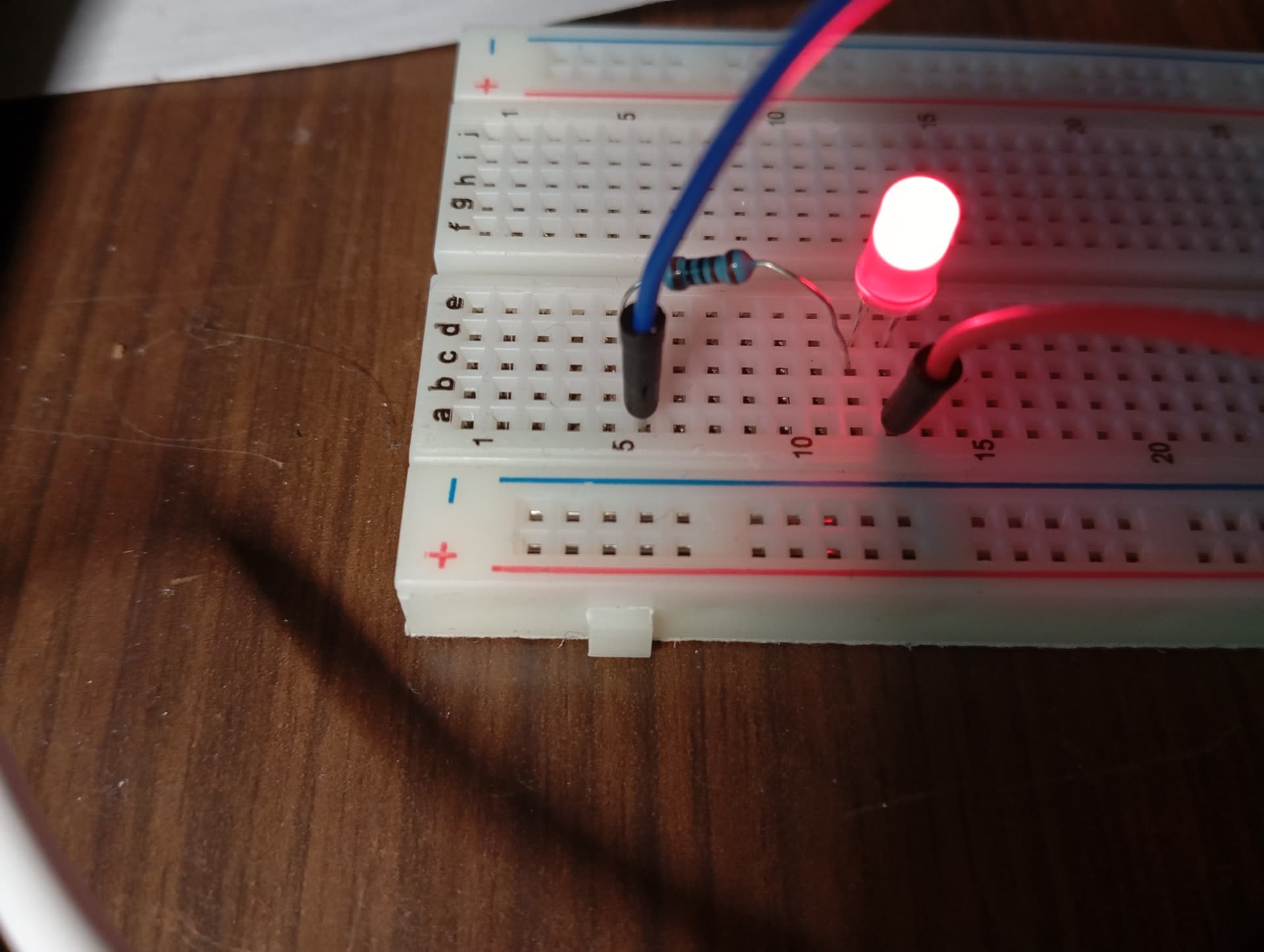

I bought arduino plus board and as I understand it must work in Arduino IDE as Arduino Uno board... Sadly it doesn't. Any idea why?

  • Show us good images of your actual wiring.
What, if anything, have you got connected to pin 7 of the Arduino ?
Tried to connect and to 6th and to 7th pin:(
Your 'photo seems to show the LED powered directly from the 5V and GND of the board
Move the blue lead from the 5V pin of the board to pin 7 (NOT A7) of the board and upload the code that uses pin 7
oh...now i get it:D sorry for so much confusion and thank you very much!
