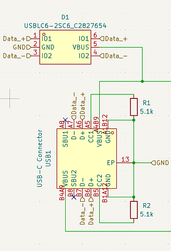

Hi folks! I have an ESP32-s3 project that I want to interface with. I am building a testing platform for this project using an Arduino Mega 2560.
The ESP32-s3 is wired to a usb-c port and is what i use to program the device and observe the serial output.
I've been trying to connect a USB-c (also tried with a USB-A) breakout to my arduino mega and ingest the serial data from the ESP32-s3.
I'm also using PulseView and a Logic Analyzer to verify.
Here is the schematic for the USB-C port that is connected to the ESP32-S3
For the USB-A connector:
VBUS - 5v power supply
GND - Connected to both the logic analyzer and the power supply ground.
D+/D- connected to channels 0 and 1 on the logic analyzer.
When I hook up the USB-A breakout to the USB-C of the device, I use a USB-C to A cable that I know carries data because I've programmed the ESP32-S3 off the same cable. However, I get no signal on the logic analyzer of any kind.
Even if i get garbage, i would expect there to be some signal coming through on the logic analyzer but no luck.
Any guidance would be super helpful!
Hi @cyonic.
This won't work. It would only be possible with a board that had USB host capability (which the Mega does not), and even then it would not make any sense to do that as it would introduce a great amount of unnecessary complexity.
You should instead make a connection between the appropriate hardware serial transmit pin on the ESP32-S3, and the "RX1" pin on the Mega board.
You will need to adjust the code of the program that runs on the ESP32-S3 so that it sends serial data via the object associated with the transmit pin on the board you are using.
You can read the data that is transmitted from the ESP32-S3 from the program running on the Mega via the Serial1.
