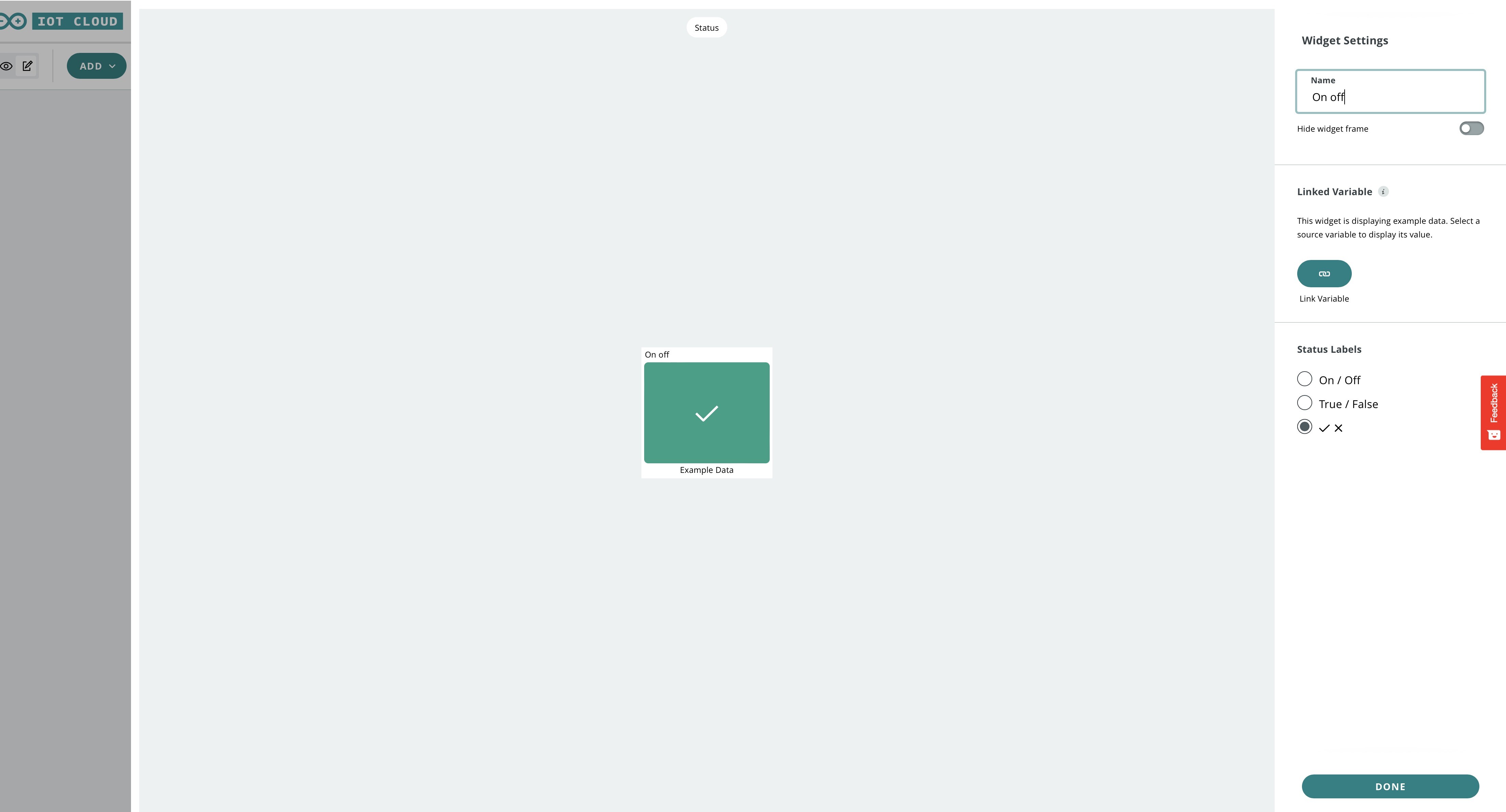

I tried everything I know. I can’t get the status or led widget to work (read/write enabled, boolean). If on the dashboard I click the led should it change colors? Or would it only change if I change the variable in the sketch. So, I tried both ways and nothing happens. The same holds true for the status widget.

This is the dashboard
The variables led & statusButton (this is a status widget, not a button, I just named the status widget statusButton) are both Boolean read only(also tried with read/write)
Here is the code

The led and statusButton on the dashboard, always green, never change, the serial print shows the 2 variables change value but not the widgets themselves. When I start the sketch I immediately got to the dashboard because the value of both is 0, then after a few seconds and connect the variables change to 1 but the widgits stay green even when variables are 0.
What am I doing wrong

You are setting a cloud variable to false when you are not connected to the cloud.
In the future please use code tags to post code.
Why do you need two bools?

i've tried this, the status still doesn't change. I am connected. i went as far as to change the status from 1, delay 1 second , 0, delay 1 second in the loop, the status is always on.. are you sure there isn't a problem with the status widgit.
thanks for your help.
Have you declared the cloud variable in thingProperties.h page, can we see that?
And where is your onOff variable in the code from post #12 ?
i also tried 1 and 0 instead of true and false for onOff
thanks
  ArduinoCloud.update();
  onOff=false;
