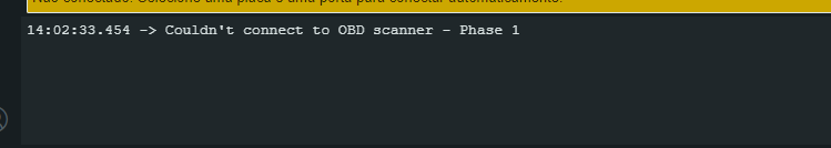

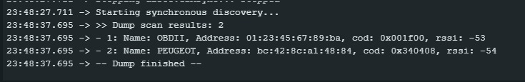

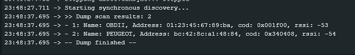

Hello again, regarding the wiring diagram, I don't think it's necessary because I'm just using the ESP32 and serial monitor to check, along with the ELM327, for which I have already provided the link earlier. The curious thing is that on the iPhone I only find it as OBDBLE, but on the notebook (which is a bit older) and through the bt_classic_device_discovery, I find the OBDII. Serial monitor:
However, when I use the ESP32_Bluetooth_Serial code, the following message appears: I have also tried using a password, but the message remains the same:
#include <BluetoothSerial.h>
#if !defined(CONFIG_BT_ENABLED) || !defined(CONFIG_BLUEDROID_ENABLED)
#error Bluetooth is not enabled! Please run `make menuconfig` to and enable it
#endif
#if !defined(CONFIG_BT_SPP_ENABLED)
#error Serial Bluetooth not available or not enabled. It is only available for the ESP32 chip.
#endif
BluetoothSerial SerialBT;
#define BT_DISCOVER_TIME 10000
static bool btScanAsync = true;
static bool btScanSync = true;
void btAdvertisedDeviceFound(BTAdvertisedDevice *pDevice) {
  Serial.printf("Found a device asynchronously: %s\n", pDevice->toString().c_str());
  SerialBT.begin("ESP32test");  //Bluetooth device name
  Serial.println("The device started, now you can pair it with bluetooth!");
  if (btScanAsync) {
    Serial.print("Starting asynchronous discovery... ");
    if (SerialBT.discoverAsync(btAdvertisedDeviceFound)) {
      Serial.println("Findings will be reported in \"btAdvertisedDeviceFound\"");
      delay(10000);
      Serial.print("Stopping discoverAsync... ");
      SerialBT.discoverAsyncStop();
      Serial.println("stopped");
      Serial.println("Error on discoverAsync f.e. not working after a \"connect\"");
  if (btScanSync) {
    Serial.println("Starting synchronous discovery... ");
    BTScanResults *pResults = SerialBT.discover(BT_DISCOVER_TIME);
    if (pResults) {
      pResults->dump(&Serial);
      Serial.println("Error on BT Scan, no result!");
  delay(100);

#include "BluetoothSerial.h"
#include "ELMduino.h"
#define ELM_PORT   SerialBT
#define DEBUG_PORT Serial
ELM327 myELM327;
uint32_t rpm = 0;
#if LED_BUILTIN
  pinMode(LED_BUILTIN, OUTPUT);
#endif
  DEBUG_PORT.begin(115200);
  //SerialBT.setPin("1234");
  ELM_PORT.begin("ArduHUD", true);
  if (!ELM_PORT.connect("OBDII"))
    DEBUG_PORT.println("Couldn't connect to OBD scanner - Phase 1");
    while(1);
  if (!myELM327.begin(ELM_PORT, true, 2000))
    Serial.println("Couldn't connect to OBD scanner - Phase 2");
    while (1);
  Serial.println("Connected to ELM327");
  float tempRPM = myELM327.rpm();
  if (myELM327.nb_rx_state == ELM_SUCCESS)
    rpm = (uint32_t)tempRPM;
    Serial.print("RPM: "); Serial.println(rpm);
  else if (myELM327.nb_rx_state != ELM_GETTING_MSG)
    myELM327.printError();
