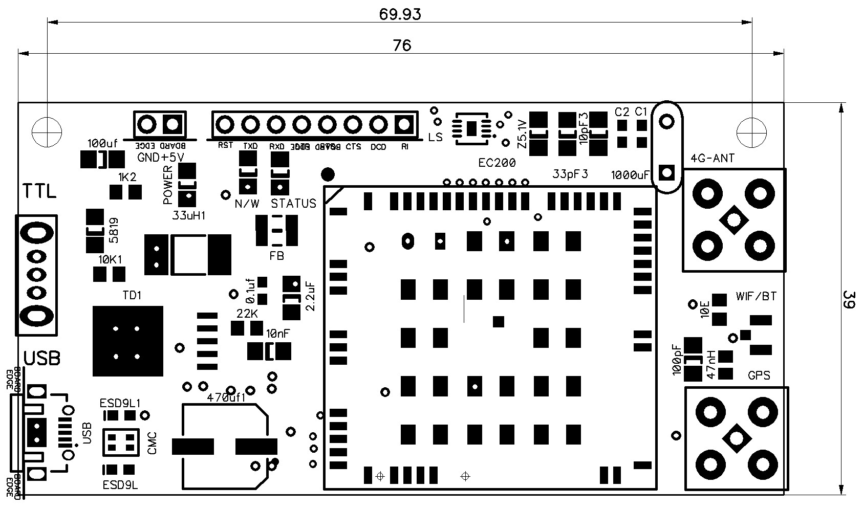

wanted to connect this device to Arduino. I want to send data from arduino to this module. I have connected the rx pin on arduino to txd pin on the device and txd pin of device to rxd of arduino . I have connected 5v pin of arduino to 5v pin of this device and ground pin of this device to ground pin of Arduino. It is not working. I am a newbie. Can you guys help me ?

there are a number of modules based on the quectel ec200u-cn
can you give a link to the specific module you are using?
not used the EC200 but have used the Quectel EC21
can second @adityasingh76 in stating do not connect 5V logic to the module IOs
also check the logic levels - I know that some of the EC21 signals use 1.8V logic - the EC200 may be similar
check that the power supply is 5V - it may be 3.3V to 4.4V
I would recommend you test using a microcontroller which uses 3.3V logic, e.g.RP2040, ESP32, etc
