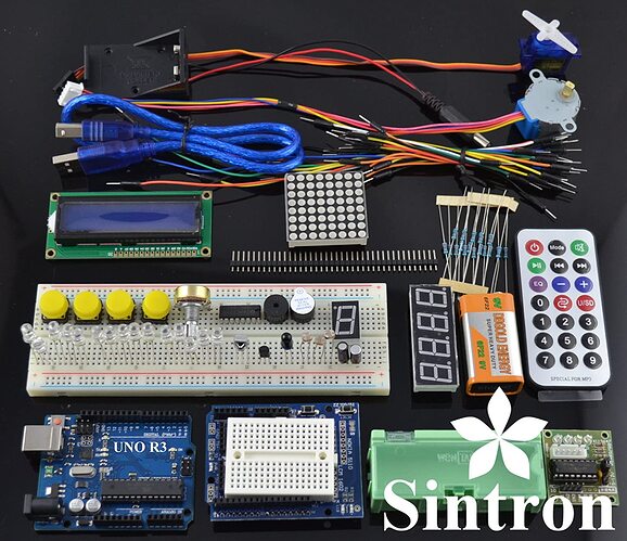

BTW: Your UNO has to be of "R3" design, or you might have a problem with pin-13 (onboard LED).
Is your UNO a "UNO R3" (original or clone) or is it a different type of Atmega328 board design?
The board is a Sintron Uno R3
Jurs, the Manual Mode seems to be good to me.

G40PY:
Yes, R3 design is what you need for this application (or you could not use pin-13).
