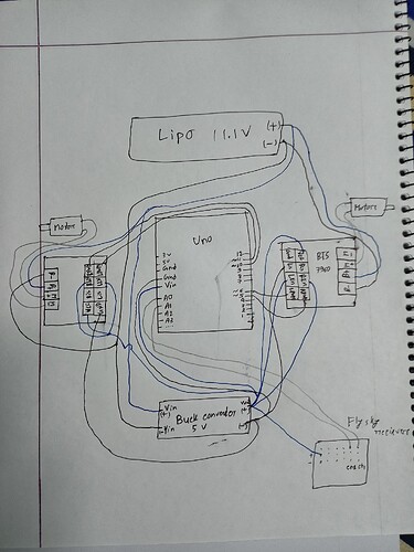

Control 2 BTS with Arduino & Flysky fs6x
So I am using the following the code to control 2 BTS 7960 to run motors. Turned on Evelin on Flysky. Now when I run it the direction of the motors is okay. Everything is working but I can only control speed of one BTS 7960 thus one motor only. The other one runs on a constant speed. Even though direction is correct. Can anyone please find out why the other BTS 7960's speed control (I am guessing "pot2") is not working?

Would you post a system drawing and a photo? It will help in diagnosing the issue.
If "everything is working but one motor does not change speed", it is probably pin mis-wire or pin mis-code, or power supplied is not enough for two (one motor has less resistance, and electricity finds the path of least resistance).
I know it is hard to understand from the photo. This is basically the circuit.
The drawing is good.
How much current do the motors and motor drivers require, and how much current will the battery (written on side?) supply?
To test the "good" motor versus the "bad" motor, either change the code to send "good" motor signals to the "bad" motor (and bad to good), or change B+/B- wires from the battery to the driver boards for "good" and "bad" battery. The problem will either stay with a motor or move to the other motor (or will start working both motors or will stop working both motors)
`#define RPWM2 3
Not sure about the current. Motor works on 12V max. And BTS 7960 can take upto 43A current. Also cannot find the battery current supply.
Battery looks right for the RC behind it. Refer to @ua6em pin change, and verify what works (and what does not) and post your results here.
Check drivers individually!!!

The drivers seems alright. If I switch 5,6 pin with 10,11 pin then the opposite motors doesn't work (speed control does not work). It means the problem is with my code. Changed define pin to 3, results are same as before.
MY SKETCH

Thank you for sharing this.
Although code for L298N motor driver shield is a bit different then mine BTS 7960.
It has one speed controlling pin for 1 motor where I have two (RPWM, LPWM) for a single motor.
