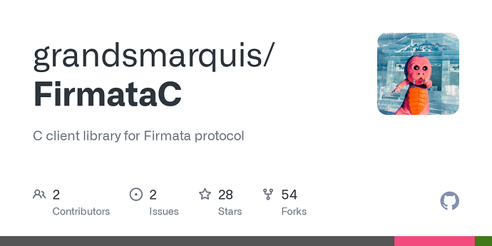

Since you want to write your client in C/C++, you also need a Firmata client library in one of those languages. I found two after a quick search:
This is something that you might be interested in:
Firmata seems to be exactly what I am looking for. I got StandardFirmata.io installed on the Arduino. I followed these instructions which I found most helpful of anything out there:
It looks like newer versions of Firmata have more Firmata under File->Examples but based on another video just chose the "StandardFirmata" option (not the ones with some other words after "StandardFirmata").
I now want to send commands from the host to the Arduino using the Firmata protocol. There is a standalone application for on the host to do so. And there are Python libraries for the host computer to do the same. dimitry-ishenko-cpp seems to do what I want but it requires cygwin or some linux environment. grandsmarquis seems to require C++ v14+. etc. According to this link GitHub - firmata/arduino: Firmata firmware for Arduino there are implementations for Python, Perl, Ruby, Javascript, Java, .NEt, PHP, etc. etc. but no C/C++??? Is there some pure WINDOWS client library that can communicate via the Firmata protocol using c/c++ that isn't bleeding edge requiring nuget packages and such?
