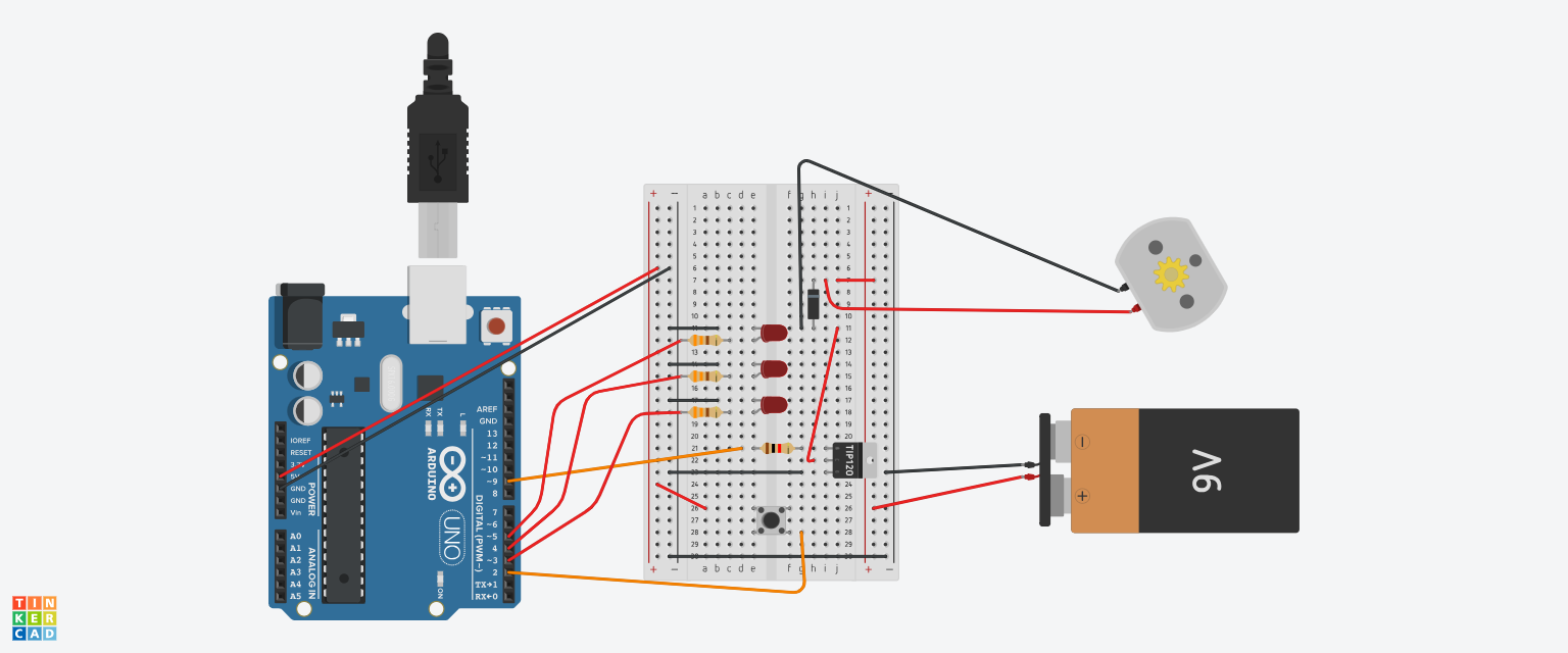

Control motor speed with npn and push button ( no driver)

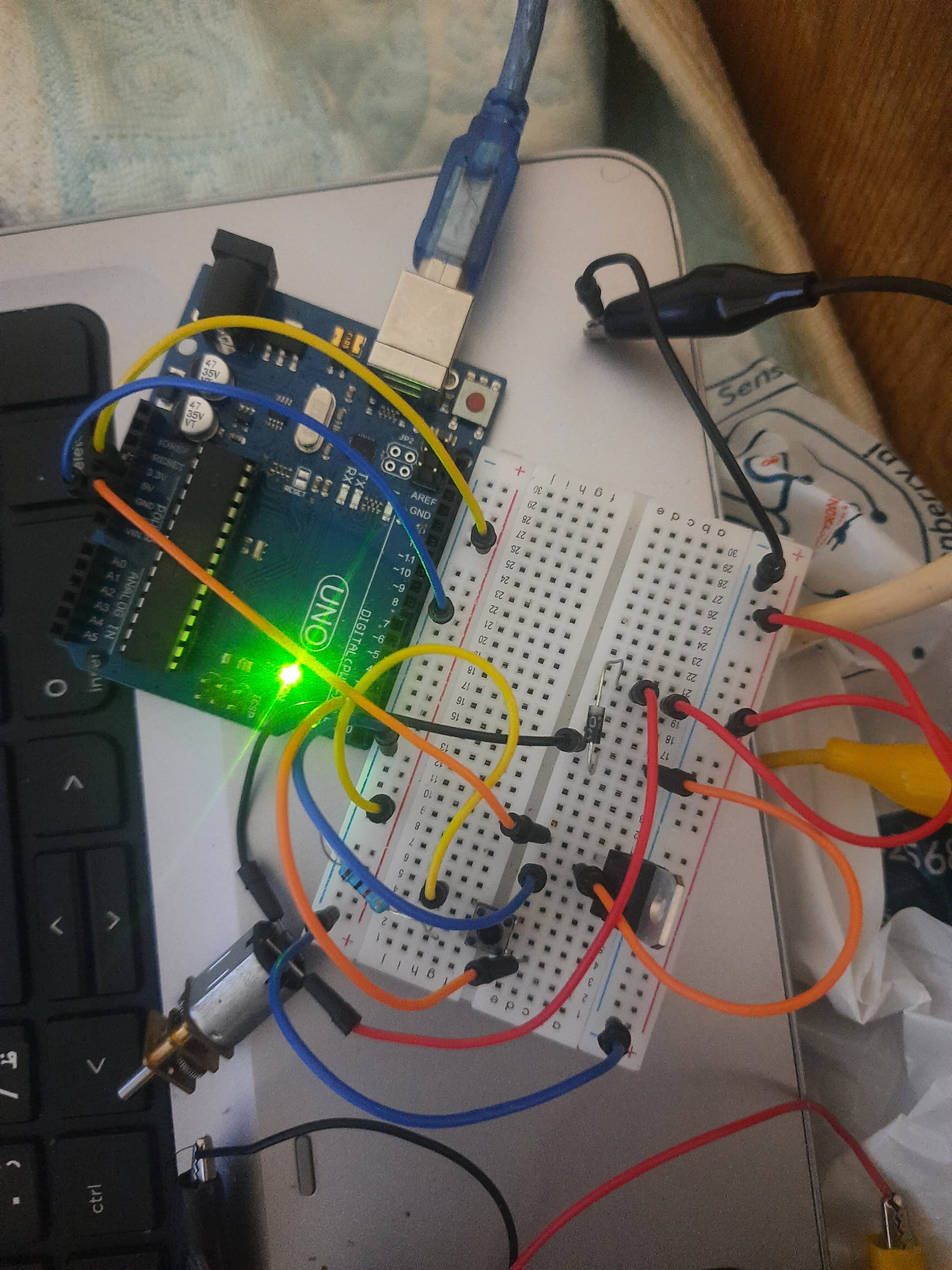

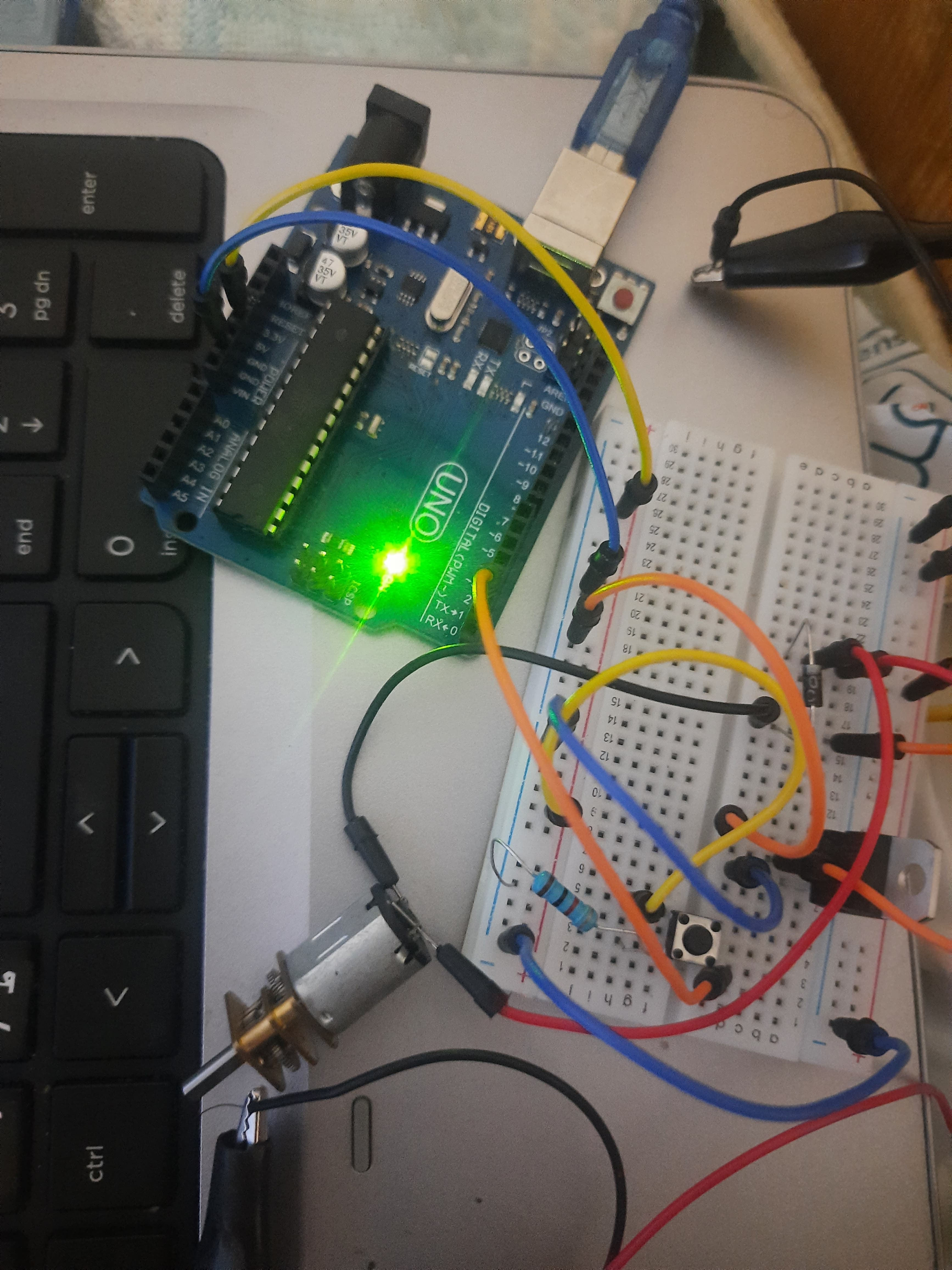

I just just replay this step and it is not working now
I even tried to add the wire to GND in the uno and the breadboard and motor did not work
The npn is new just bought it today
When i add it the motor is rotate slowly and when remove the speed of motor increase
I think it is unless here also
Without the 2K resistor in the circuit properly it won't be new for long. You are stressing Vbe without it.
Put the resistor in like you shown in post #9
This is the third time.
What is the part number of your transistor ?
  • You must have a resistor between Arduino pin 9 and the NPN base !
Are these soldered ?
That's a good question. He never said it's a TIP120. It shows as TIP120 in his frizzy but it could be anything
TIP120 NPN
I reply this before
  • no not soldered but the are very tight
You might have damaged the transistor base and/or Arduino pin 9.
Add a resistor.
  • Do you have a new TIP120 ?

Ok will try with new TIP120

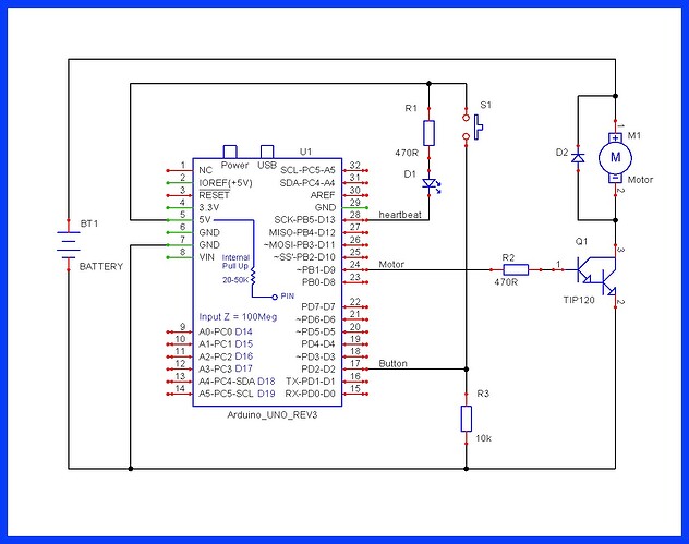

Remember to add a resistor 470R to 1k between Arduino pin 9 and the TIP120 transistor Base.

thanks Larry and 2112 it is now working successfully with the larry's code, the problem was with TIP120 seem to be fire when there is no resistor to the base
