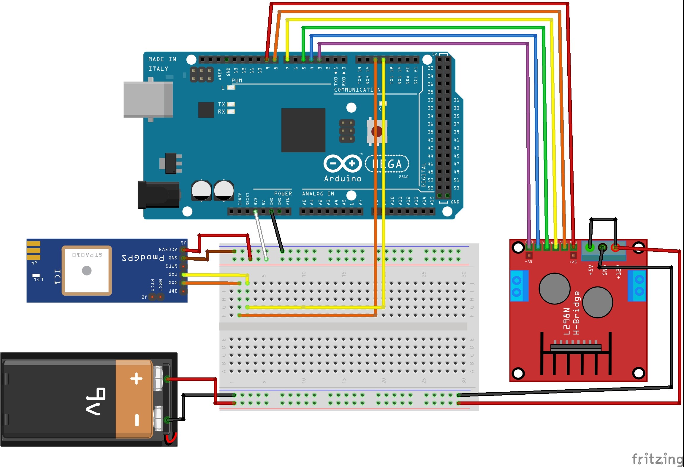

I'm working on a project where we have to make a trolley follow the user.
I'm using:
2 Xbee 802.15.4
2 Arduino Mega
2 PmodGPS
2 DC Motors
1 L298N Dual H-Bridge Motor Controller - power by external 9V battery
I've got the GPS data being transferred between the two arduinos, I've worked out the distance and I have worked out the bearing as well, all thanks to users from this forum.
Now that I'm getting this working, I tried to program it so that it runs the motor when its more than 5m apart. I've tried to make it work but due to my novice programming skills, it didn't. :frowning:
My thought process was that if the distance is more than 5m, the arduino should put the motor controller pin HIGH. If its not then all the pin would be set to LOW.
I tried creating a separate void declaration for controlling the pins. That didn't work. The last thing I tried was to just put the HIGH LOW code in the ShowParsedData loop. That obviously didn't work either.
Could anyone tell me what I'm doing wrong and how I could achieve this?
Please let me know if I've missed something, or if anyone wants more details.
N.B. If the some parts of the Rx code look out of place and/or stupid, I've been doing a trial and error to get it to work, so I've moved some stuff here and there, just to see what happens.
High Regards

Here's my serial monitor display:
Fob Sats: 4
Fob Lat: 43.383045
Fob Lon: -2.478903
Trolley Sats: 5
Trolley Lat: 43.383033
Trolley Lon: -2.478810
Distance: 6.252509
Bearing: 278.768463
bump
I think you need to connect the grounds of the Arduino and the 9V. If you have it set up as on your image try putting a jumper wire between the ground rails on each side of the breadboard.
Hey thanks a lot for your reply.
Yes, the fritzing image is accurate I made it after setting it up and its mainly for me to remember the wiring.
I did as you suggested but no response from the motors. I know the motors and the motor controller works because I've tested them with their basic codes and what not.
This is the serial monitor result, meaning the distance is more than 5m so it should work, logically:

In the code that I posted above, I've put
if (trolley.valid.location) {
    float distance = trolley.location.DistanceKm( fobLoc ); //measures the distance as a float of 6 decimal points
    distance = distance*1000;
    Serial.print( distance, 6 );
    if (distance > 5.000000)
    digitalWrite(in1, HIGH);
    digitalWrite(in2, LOW);
    digitalWrite(in3, HIGH);
    digitalWrite(in4, LOW);
  if ( distance < 5.000000)
    digitalWrite(in1, LOW);
    digitalWrite(in3, LOW);
in the showParsedData loop. I feel that thats not where its supposed to be, but I could be wrong.
Any other suggestion?

Isn't it a bit optimistic to expect five metre accuracy with GPS? (Assuming you're not using DGPS)
GrooveFlotilla:
Maybe, but that's alright, I can change it and work around it. I'll be alright with even 10 m, but that won't matter until the I can make the motors move.
But you didn't show us where you put it.

Hope that's clear, a bit difficult to explain. I don't think it fits there, but I'm actually unsure where it will go. I tried making a separate declaration like void moveTrolley() but that didn't work either.
Are you saying that the motors don't turn on if the distance is greater than five?
That would seem to be a wiring problem, not coding.
Do you have a simple foolproof test program to switch the motors on/off/reverse?
GrooveFlotilla:
Yes exactly. The distance from the GPS that i'm getting is around 20 meters, sometimes goes as low as 6 m. So logically, the motors should turn on as soon as the arduino calculates the distance.
