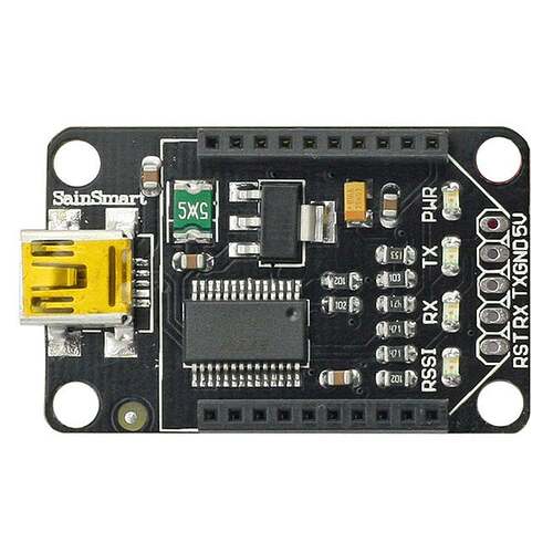

I used SainSmart XBee USB Adapter Explore to set up the xbee's on XCTU

Solik - I can use it with El Capitan, the one I use is in the link below.
Features
Used for the XBee module configuration parameters
Easily connected to a PC via mini USB cable
XBee-setting support software X-CTU
Also used as a USB-TTL adapter
Voltage: +5V(USB Power)
I was able to upload firmware easy, using X-CTU. Perhaps try using X-CTU with the shield you have?
