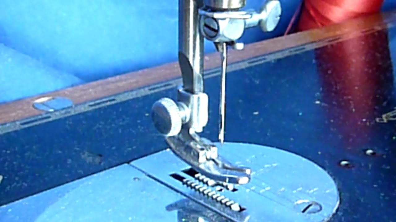

I have built a sewing machine motor control that implements much of what you seem to be looking for. It uses an Arduino Nano to control a standard sewing machine motor. The motor itself is from a typical universal motor kit such as you can buy to fit nearly all vintage sewing machines.
I own and use a vintage Adler sewing machine (from 1926) for leather projects. The usual foot pedals make it difficult to control the machine at low speed, so I made my own. The fact that I'm sewing leather makes it more complicated. Leather takes more force to puncture, then it "grabs" the needle when it starts going back up. It is very difficult to manage a steady (slow) speed when sewing leather.
The controller uses a slotted disk and infrared detector pair to read the speed. There's an interrupt that counts the time for each pulse.
For smooth control of the output, I use the TimerOne library. It gives me 1023 steps of PWM.
It uses AutoPID with the pulse period to calculate the PWM output to maintain the speed - pretty much no matter the load on the motor.
Since I'm not good at PID tuning, it uses the pidautotuner library to determine the needed PID coefficients. Push button tuning.
It can run steadily at 60 stitches per minute - or a bit lower.
It has a "low speed" mode where it holds a set speed, then when you push the pedal a little further it goes into proportional mode - press harder for faster.
The only thing it doesn't do that I think you wanted was needle positioning. I didn't put a sensor in for it, though it shouldn't be hard to add one if it's really needed. I just nudge the foot pedal when I need to raise the needle (or do it by hand.)
The code for the finished project is on my GitHub Bigfoot page. That includes the software, all the hardware (circuit diagram, PCB layout, components, etc.) as well as all the drawings I made to build the housing for it.

I did not know about this quite cheap encoder, that you links to. You are right, that I want to be able to use low speed for heavier fabrics and heavier thread (Tex 135). In order to sew leather you got such requirements. But you need that for strong seems in vinyl or dense webbing as well.
In this video (you see linke above as well), you see five tests, you can do to make sure, that you got good speed control. The machine use a speed reducer, an universal motor and electronics with a small DC-motor for speed feed-back. It is conventional electronics and no Arduino:
This video demonstrate a speed range on sewing machine of 8 to 540 stitches/minute.
In my experience, you need the motor to provide a torque on the main shaft of the sewing machine of at least 3 Nm, and with the common universal motors for sewing machines, you can achieve that with a gear ratio between motor and machine of 1:20. You find the torque-speed characteristics of some of the common sewing machine universal motors here:
https://youtu.be/VLU_s1RGasA&t=216
When you sew at low speed, it will only be a small part of the time, that a high torque is needed. The universal motors and the DC-motors I look for would overheat, if the high torque should be provided continuously, but it would not happen. Some way of measuring current and estimate the motor winding temperature could add some protection of the motor against over temperature. I have got one of the 250 W Chinese universal motors, and it heats up very fast, when it provides torque near its maximum.
Furthermore, I should like the machine to sew fast like 1800 stitches/minute. A few popular vintage household sewing machines are able to handle that, such as Pfaff 130 or Pfaff 230. I think some of the smaller cheap DC-motors designed for use in powerful battery tools might be able to handle this. The universal motors for sewing machines are not able to do that range of speed and torque.
