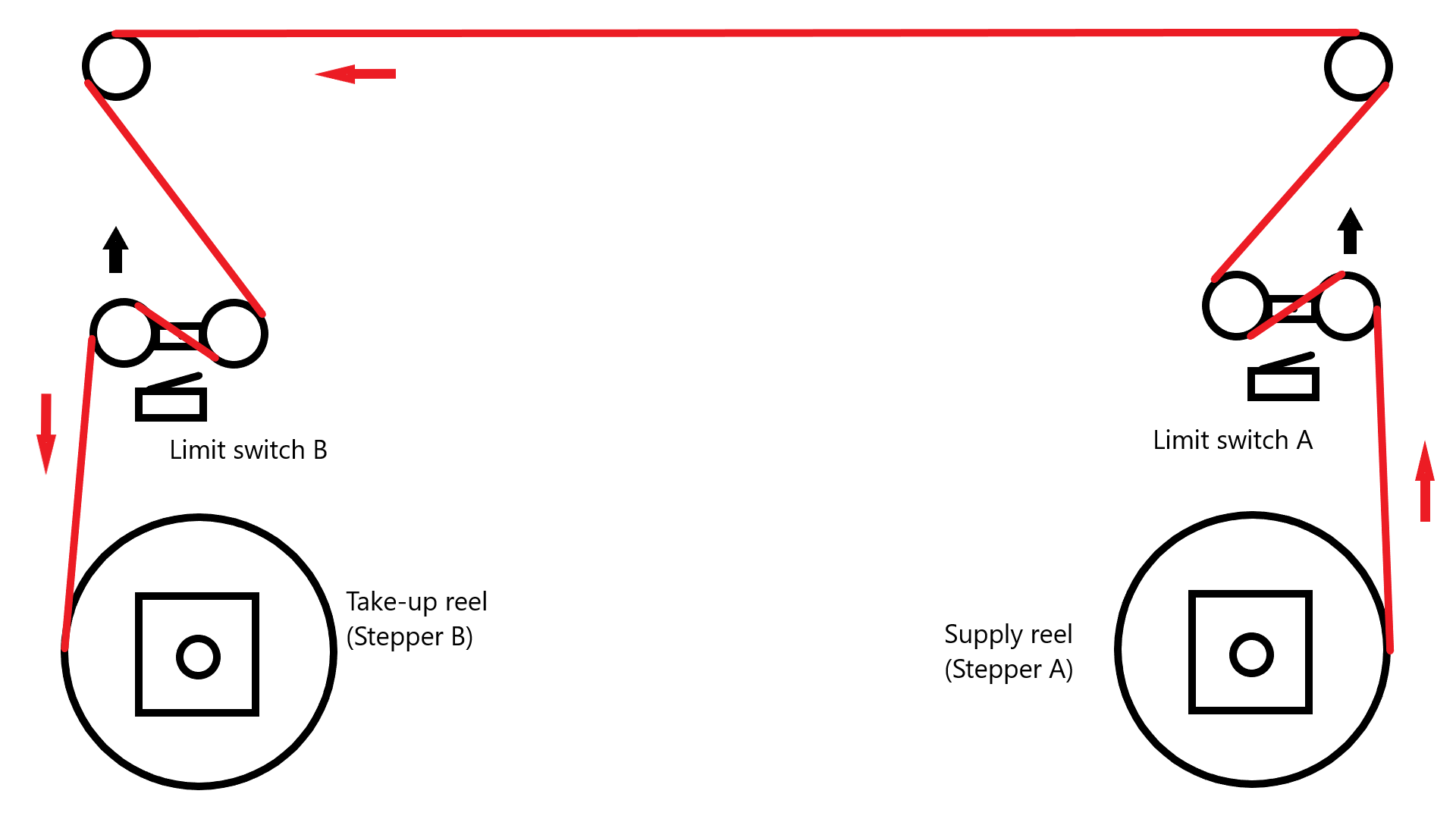

Hi everyone,
I'm new to Arduino and been trying to get some code working for making a cine film scanner. I have copied parts of code from other setups but I know I must be doing something wrong!
Anyway this setup is basically for keeping tension on the film and also having a rewind option. I have two limit switches that activate when there is tension on the film and then will turn the stepper motor to give some slack. This is for both the supply and take up reels.
There is also rewind button which will rotate the stepper faster to rewind the film after scanning.
Anyway the code kind of works with issues. Currently only one stepper motor will work at a time, but they both need to be able to work at the same time. Also the rewind option will work normally but once limit switch is activated it will start moving slowly.
I might also want to add an IR breakbeam to rewind option so it cannot be activated by mistake and must be a break before it can be activated.
I don't know if my const int are correct or if I should be using #define instead.
Hope this makes sense!

How are you powering your steppers and what are you using to drive them?

I will get a drawing of circuit done and attach when done.
The stepper motors are being powered by 12 V and using DVR8825 drivers.

Have attached image of circuit if this helps.
Thanks.. OPs circuit;
Tom... :slight_smile:
The 5V supply should go into the ProMini at the Vcc pin, not Vraw.
Vraw is for 7 to 12V supplies and connects to the input of internal 5V regulator.
Vcc is the 5V supply rail for the controller.
Make sure the gnd of both supplies are connected together.
Tom.. :slight_smile:

Perhaps this will make it clearer to understand. There is actually a third stepper motor with film sprocket but this is controlled by the raspberry pi so not shown in image attached.
To turn off the driver, just set the resetpin low again after the step, your already turning it on every step.
Picture helps alot
I think the original code was better suited for this, your “tried” code and it’s 25ms delay between steps seems wrong considering the limitswitches are the feedback control, not time.
