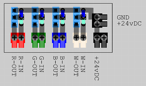

I drafted something to slap on an experiment board, should still be reasonably compact;
The blue things are supposed to represent the mosfets,
the horizontal block terminal is supposed to be a barrel jack socket,
my drafting software didn't have those.
Parts list;
4 x Resistor 220Ω 1W 5% Axial Metalfilm
4 x Resistor 10kΩ 1W 5% Axial Metalfilm
4 x Mosfet IRL540NPBF 140W
5 x Screwblock Terminal 2 poles
1 x Powerjack Barrel socket
1 x Experimenting PCB
Does that all look alright?
Its about 4 times as expensive and 4 times as large as that ebay amplifier, but better safe than sorry I suppose.
