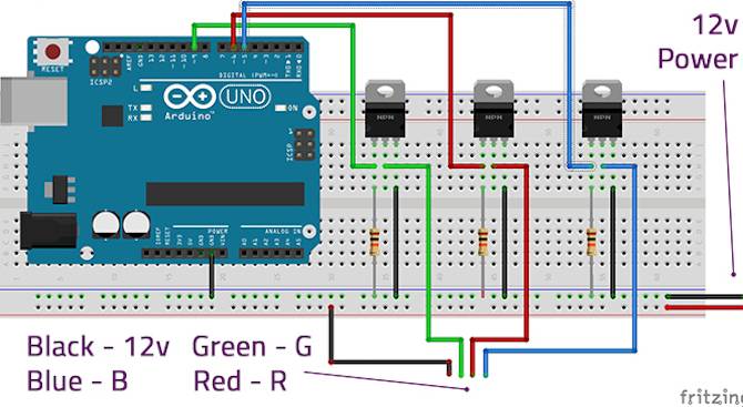

Hello. I am try to control 5 to 15 meters of 24V Led Strips with my computer via an Arduino Uno.
These are the strips
My Arduino Uno came from this kit
I am following this guide, following the diagram they provided, including these MOSFETS.
Wiring Diagram:
This is my current setup:
My concern is about how to provide the 24V of power to the strips. I have this power adapter and a connector that I could plug into the breadboard:

What you want to do is possible but with what you have given I will not even take a guess. Your pictures are useless. Post a schematic showing how you plan on connecting this. Retake the pictures so they are clear and text is readable. We will help you with your design but we do not offer a free design service. There is a for hire if you want this type of service.

That is a wiring diagram, not a schematic. Several portions are missing. Part numbers do not match, wires are not connected. How much current are the LEDs going to use?

Okay, I'm trying to get the details everyone requested.
Here is the schematic wiring diagram:
I'm trying to adapt this to a 24V Led strip, and that's one of the processes I'm struggling with.

If safety is a concern and it should be, then I recommend getting rid of the solderless breadboard.
If you want to turn the power supply off when not in use, you could use a relay controlled by the Uno. However it will require working with mains voltages (220V) and safety would be extremely important.
