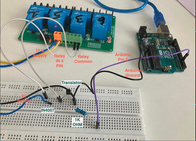

I have got a 4 channel relay that gets triggered with 12V and was given to me as it can be controlled using arduino. Late I realized since arduino can't supply 12 V thru its pins, it would be hard to control it. Hence I searched and after many attempts was able to create a circuit to trigger one channel of the relay using 2 external power sources --- one 12V to power on the relay board and one 9V to trigger one channel of the relay.
Now while my circuit is working perfectly fine for one channel, I am unable to expand it to build it separately for 4 channel relay, with an aim to control all 4 channels at the will of triggering them via Arduino. Is there a way to get this solved?

Circuit Diagram:

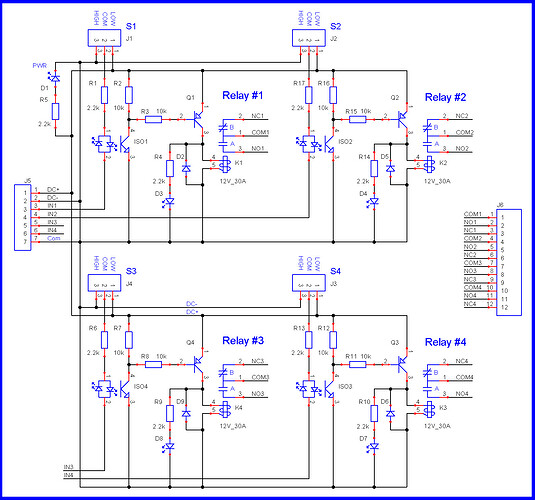

Show us a good schematic of the actual relay board module you have purchased.
Here's the schematic with actual relay image.
According to the data from your link, the relays should be able to be controlled with 3.3 or 5 volt logic.

yes, that's how I got tricked as well. The website description is incorrect I think since the relays don't get triggered that way, rather only above 9V atleast. Have tested this multiple times and hence ended up using 9V

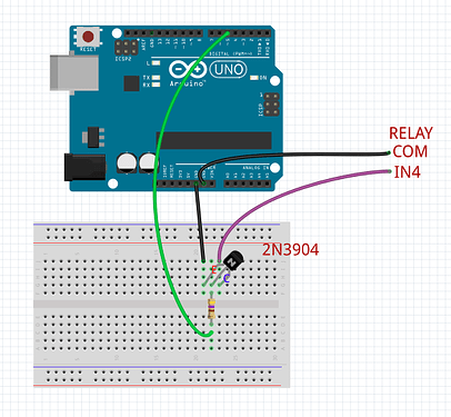

Your board already has optocouplers on it
You just need to make the correct connections to the Arduino
You don't need the 9V supply or diode.
Connect the transistor collector to the relay IN4.
Connect the Arduino GND to the relay board COM and the transistor emitter.
Keep the transistor base connection as you now have it.
Set the jumpers on the relay board for trigger LOW.
When you set the Arduino pin HIGH, the relay should go on.
Thank you!
This worked perfectly fine and I am able to control multiple relays now without issue and without using external 9v supply

There are already opto couplers on that board, and transistors.
No external transistors needed. Just drive the optos directly from an Arduino pin.

  • Anyone have a schematic of this relay module ?
Four jumpers to select active HIGH or LOW.
Seems fully opto isolated.
Leo..
Yes
Was looking for a schematic to post when this comes up next Thursday.
:wink:
Please, someone who has a 4 channel relay (12V) module like this, confirm from the PCB traces this represents the relay circuit shown below ?
