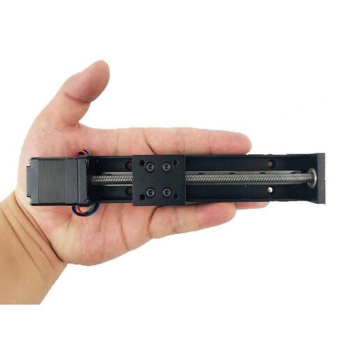

I have a laser engraver that the plan is to connect each leg to a Nema 11 stepper motor, so 4 motors total, and this would essentially make an adjustable Z-axis and lift the whole machine up and down. Each motor would have the same settings (speed and direction) and act as one. It is not heavy.
I will be controlling this with 2 momentary pushbuttons: one for up and one for down. It is only to move while holding down a button and stop when I release. This z axis will only be used to place larger/smaller items under the laser head and will not to be running while the laser is running. It's just a lift to help adjust laser height and focusing.
Being that the motors will be operating at the same speed, direction , steps, etc and using the same information, can I just splice all together and connect to the arduino uno, or will each motor still need to be connected to their own set of 3 pins on the arduino uno? Same with whatever other pins go from the easydriver to the uno, could those just be spliced and sent to same pins on the arduino?
I have an arduino uno, 2 sparkfun easydrivers, 2 stepper motor splitters and the pushbuttons.
The plan is to connect 2 motors using the splitter to 1 easydriver each, and then send the two splitters to the arduino. Can I just send the 2 sets of stepper wires to the same 4 pins? (Picture attached)
Please excuse the poor mockup, but that's what I'm looking to do. Will the attached schematic work? If so, can someone help me with the code as well as the ACTUAL wiring to the arduino uno? Thank you all in advance

Connecting several stepper drivers to the same Arduino pins does not present an electrical problem. But what will you do if one of the motors misses some steps?
I have no idea how your "splitters" work but connecting two motors to one driver may not be a good idea. How will the driver regulate the current?
Can you post a link to the datasheet for the "splitter"?
And please post a link to the datasheet for your motors.
...R
Considder getting 4 of the A4988. They are cheap.
They take 2 signals. Step and direction.
You can tie all step together.
Then all direction together

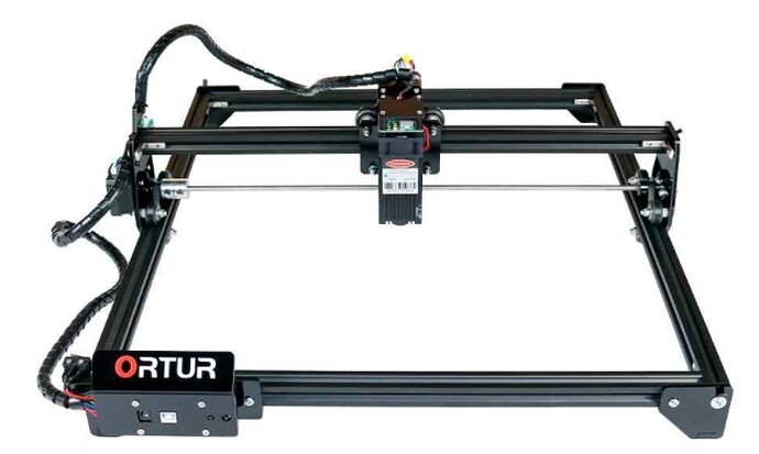

Yes. This is just a vertical lift. Separate mechanically and functionally from the laser engraver itself. Just to hoist the engraver above what is to be engraved.
Unusual construction, but okey. Just hard to guess.
Railroader:
I could just do one z axis motor on the actual laser head, and lift the laser head up an down, but I don't want the added weight on the laser head/rails.
Why I decided to lift the whole engraver itself instead.
It's an Ortur Laser Master 2.
Plan is to attach the legs to the lifts with this leg holder I designed and 3d printed.

I have a few easydrivers. 2 real sparkfun ones and 5 clones, but I'm trying to keep the encloser relatively small. Don't want to make it much bigger if I don't have to. Looks like the splitters divide the current evenly and they're wired in parallel
I am going to be using a 24V 3A power supply to power them.
Whether I use 2 or 4 drivers, it sounds like I would still wire it the same to the Arduino since I can splice together the drivers/motors.
Can anyone draw me up a wiring diagram to the pins on the Arduino and supply code for basic 2 button functionality (slow up and down)
