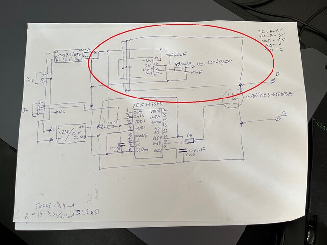

So let's have a look at the hardware first. Can you post a schematic? Also, controlling transistors is probably not the ultimate goal of the setup; what are the transistors in turn switching/driving?

Thanks for the schematics.
Why have you got the current loop shorted?
Please review your schematic and project?
Can you post some images of your project?
So we can see your component layout.

Trust me my project is working fine. I need support for the controling of the transistor with arduino. I have achieved some results, but i need more frequency.
