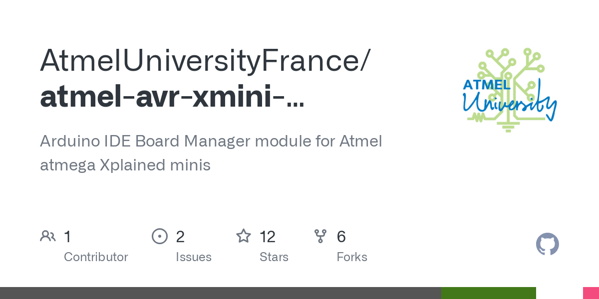

The Atmega328P is a totally different chip. Have you got a device driver for that chip loaded up?
I looked in the board manager and found only one board driver for that chip.
The Github page for this is
I have not tried it, but it is a start.

An UNO contains one, but for barebones Atmega328 MiniCore works really well.

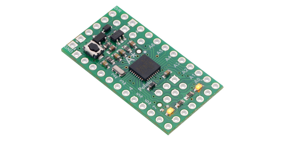

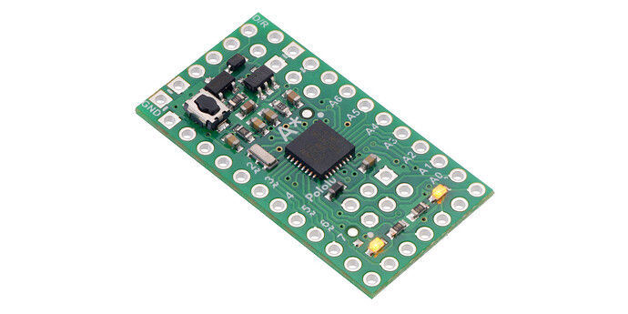

Arduino Uno contains contains an Atmega328P - PU.
This is the one I thought he meant
In my defence the OP did say
Which I took to mean Compile. Apparently he didn't. :roll_eyes:

Ah yeah the PB, that is a completely different chip, with you on that.
