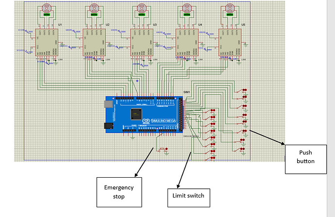

im controlling 5 stepper motors using arduino mega .two of them have to be synchronized( like moving at the same time and same direction) im using momentary push button for the control,each motor will two momentary push button 1 for backward motion and the other forward motion.i have done the simulation in proteus and it was working well as expected after that i realize that i should include limit switch and emergency stop button in my circuit and integrate it in the code and thats where the problem come up.with those component added in the circuit and the code the motor start moving and stop right away.
i have shared below the code and the circuit.

In your code you define emergency stop as 42.
" const int emergencyStopButton = 42; // Pin for the emergency stop button"
But in your schematic it is wired to A10.
A10 is digital pin 64.
//Analog to Digtal equiv.
//A0 (54) A1(55) A2(56) A3(57) A4(58) A5(59) A6(60) A7(61)
//A8 (62) A9(63) A10(64) A11(65) A12(66) A13(67) A14(68) A15(69)

That doesn't fit together. InterfaceType 1 means step/dir driver and needs only 2 pins. Please tell what stepper and driver you are using.
A picture of your setup would help to understand what you are doing and how the limit switches are used.
Can you explain a little bit more? How long does it move?
Like it moves just for 5 second and its very slow
No it is not wired to A10 if you could zoom you will see that its not ...
Im using motor-bitepper and L298 stepper motor driver
I'm not used to this schematic "quality".
I'm from the time when schematic was schematic,
