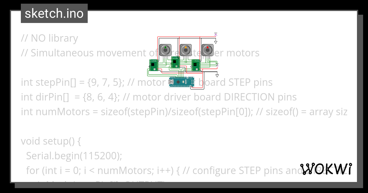

// NO library
// Simultaneous movement of three stepper motors
int stepPin[] = {9, 7, 5}; // motor driver board STEP pins
int dirPin[]  = {8, 6, 4}; // motor driver board DIRECTION pins
  for (int i = 0; i < 5; i++) { // configure STEP and DIRECTION pins
    pinMode(stepPin[i], OUTPUT);
    pinMode(dirPin[i], OUTPUT);
  delay(10); // slow the simulation
  for (int i = 0; i < 3; i++) {
    digitalWrite(stepPin[i], HIGH); // start of start pulse
  delayMicroseconds(2000);
    digitalWrite(stepPin[i], LOW); // end of start pulse
I am working on school project and I have to manage work of 5 motors on 4 axis robotic arm. Fifth motor is extruder motor. And I´ve searched for many videos... and talked to many different AI(chatGPT...) and didn´t manage to find solution yet.

What does your code need (post #13) that my code does not have (post #10)? Take my code and add the things you need.
