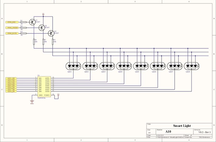

Hi I'm currently controlling 8 rgb leds common cathode with a ULN2803, however I need to use these smaller square rgb leds for a project, but they are common anode.
Got this scheme from a tutorial on youtube, but I need to change it to fit the common anode rgb leds.
I know I have to use NPN transistors instead of PNP transistors connected to the 3 PWM pins that controll colors; with emitters connected to GND.
However the ULN2803 doesn't seem to work with common anode leds, i believe it is because the transistors inside the ULN2803 only work one way.
Is there something similar to the ULN2803 but inverted, i mean, that can work with common anode leds?
Or what else should I use if there is no symmetric replacement?
Thanks
The WS2801 or WS2803 work with common anode.
Having not found any shop near me (online or offline) that sells these WS2803, I ended up finding a chip similar to the ULN2803 that could work with commmon anode rgb leds... maybe.. it's a UDN2982A. Do you think this could be used for my project, with similar pinnning than the ULN2803?
You can get the WS2803 from eBay without problem (it's where I bought mine). One thing I forgot to mention about the WS2803 is it's capable of doing PWM so you don't need to use PWM pins on the arduino.
I don't think the UDN2982A is really suitable, because it's a source driver it would be connected to the anode and not the cathode. Other may have different ideas.
